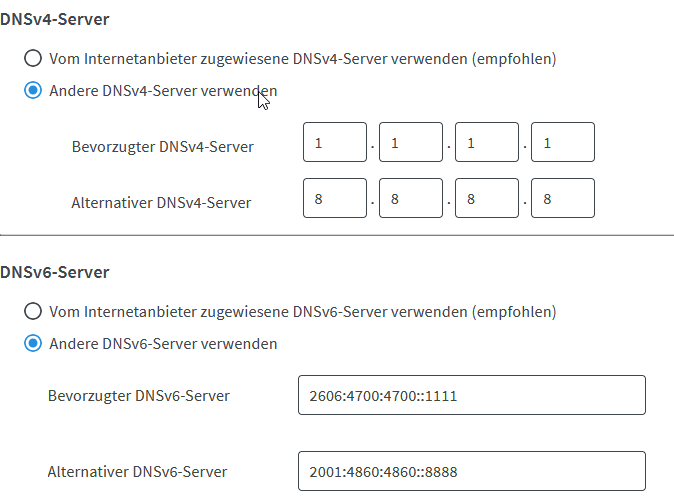

What did explicitly write on your fritzbox @Grafhugo ?
Whats 1st and 2nd dns and did you state them for ipv4 and for ipv6?
See what I mean (I use other dns entries, dont get confused by them)
