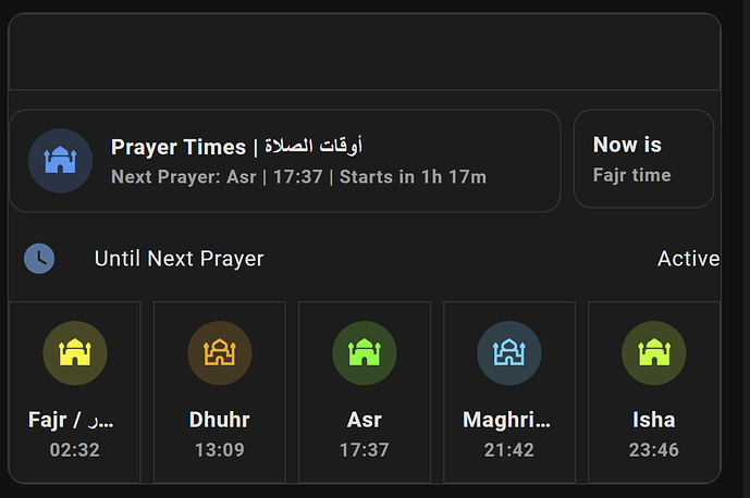

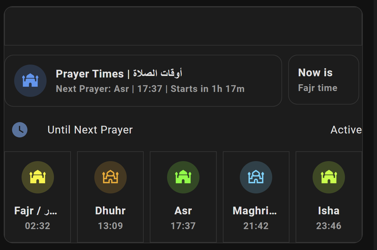

Thanks for sharing the code. I got most of the stuff to work but have 3 issues
  1. Islamic date won’t show up on the top
  2. the timer bar won’t work
  3. not able to get Fajr & الفجر in separate lines
This is yaml for my card
β€˜β€™β€˜β€™β€˜β€™β€˜β€™β€˜β€™β€˜β€™β€˜β€™β€˜β€™β€˜β€™β€˜β€™β€˜β€™β€˜β€™β€˜β€™β€˜β€™β€˜β€™β€˜β€™β€˜β€™β€˜β€™β€˜β€™β€˜β€™β€˜β€™β€˜β€™β€˜β€™β€˜β€™β€˜β€™β€˜β€™β€˜β€™β€˜β€™β€˜β€™β€˜β€™β€˜β€™β€˜β€™β€˜β€™β€˜β€™β€˜β€™β€˜β€™β€˜β€™β€˜β€™β€˜β€™β€˜β€™β€˜β€™β€˜β€™β€˜β€™β€˜β€™β€˜β€™β€˜β€™β€˜β€™β€˜β€™β€˜β€™β€˜β€™β€˜β€™β€˜β€™β€˜β€™β€˜β€™
</>type: custom:stack-in-card
cards:
  • type: custom:button-card
    variables:
    currentview: |
    return window.location.pathname.split(β€˜/’).slice(-1);
    entity: sensor.islamic_day
    show_name: false
    show_state: true
    color_type: card
    card_mod:
    style: |
    ha-card {
    margin-top: 1px;
    margin-bottom: 1px;
    margin-left: 1px;
    margin-right: 10px;
    border: skyblue solid 5px !important;
    styles:
    card:
    - height: 3em
    - align: center
    - font-weight: bold
    - background-color: β€œβ€
    - color: orange
  • type: custom:layout-card
    layout_type: custom:grid
    layout:
    grid-template-columns: auto 100px
    grid-template-rows: auto auto
    margin: β€œ-4px 0px -10px -4px;”
    cards:
    • type: custom:mushroom-template-card
      primary: Prayer Times | Ψ£ΩˆΩ‚Ψ§Ψͺ Ψ§Ω„Ψ΅Ω„Ψ§Ψ©
      secondary: |-

        ha-state-icon {
          {% if states('sensor.current_prayer') == 'Maghrib' %}
            animation: spin 2s linear infinite;
          {% endif %}
        @keyframes spin {
          0% {transform: rotate(0deg);}
      mushroom-state-info$: |
        .primary:after {
          content: 'Ψ§Ω„Ω…ΨΊΨ±Ψ¨';
          display: flex;
          flex-direction: column;
          color: skyblue;
        .container {
          --secondary-text-color: rgba(238,238,228, 0.9);  /* A soft amber for a warm contrast */
          --primary-text-color: orange;
      primary: Isha
      secondary: |
      {{ states(β€˜sensor.isha_time’) }}
      tap_action:
      action: more-info
      entity: sensor.current_prayer
      icon: mdi:mosque
      icon_color: β€œ#B6ff00”
      layout: vertical
      card_mod:
      style:
      ha-card {
      /* Set size and spacing of button */
          {% if states('sensor.current_prayer') == 'Isha' %}
            border: 1px outset green; /* Example border color */
            background: rgba(161, 0, 255, 0.5) !important;
          {% else %}
            background: rgba(21,76,121, 0.5) !important;
          {% endif %}
          width: 75px;
          --spacing: 8px;
          padding-bottom: calc(var(--spacing) * 1.718) !important;
          margin-bottom: 5px;
          /* Styling of button */
          box-shadow: var(--ha-card-box-shadow) !important;
          border-radius: calc(var(--ha-card-border-radius, 15px) * 1 ) !important;
          /* Center button */
          margin-left: auto;
          margin-right: auto;
          transition: all 0s;
        /* Add subtle color on hover */
        ha-card:hover {
          background: rgba(255, 235, 59, 0.5) !important; /* Soft amber on hover with reduced opacity */
          border-color: orange; /* Orange border on hover */
        ha-state-icon {
          {% endif %}
        @keyframes spin {
        .primary:after {
          content: 'Ψ§Ω„ΨΉΨ΄Ψ§Ψ‘';
          display: flex;
          color: skyblue;
        .container {
card_mod:
style: |
ha-card {
/* Styling of card background */
background: linear-gradient(to bottom right, rgba(95, 158, 160, 0.85, 0.85) 30%, rgba(33,19,13, 0.85) 100%);
β€˜β€™β€˜β€™β€˜β€™β€˜β€™β€˜β€™β€˜β€™β€˜β€™β€˜β€™β€˜β€™β€˜β€™β€˜β€™β€˜β€™β€˜β€™β€˜β€™β€˜β€™β€˜β€™β€˜β€™β€˜β€™β€˜β€™β€˜β€™β€˜β€™β€˜β€™β€˜β€™β€˜β€™β€˜β€™β€˜β€™β€˜β€™β€˜β€™β€˜β€™β€˜β€™β€˜β€™β€˜β€™β€˜β€™β€˜β€™β€˜β€™β€˜β€™β€˜β€™β€˜β€™β€˜β€™β€˜β€™β€˜β€™β€˜β€™β€˜β€™β€˜β€™β€˜β€™β€˜β€™β€˜β€™β€˜β€™β€˜β€™β€˜β€™β€˜β€™β€˜β€™β€˜β€™β€˜β€™β€˜β€™β€˜β€™
These are my sensors’
</> - sensor:
- name: β€œNext Prayer”
state: >
{% set current = now().strftime(β€˜%H:%M’) %}
{% set times = {
β€˜Fajr’: states(β€˜sensor.fajr_time’),
β€˜Dhuhr’: states(β€˜sensor.dhuhr_time’),
β€˜Asr’: states(β€˜sensor.asr_time’),
β€˜Maghrib’: states(β€˜sensor.maghrib_time’),
β€˜Isha’: states(β€˜sensor.isha_time’),
β€˜Sunrise’: states(β€˜sensor.sunrise_time’)
{% set next = namespace(name=β€˜Isha’, time=times[β€˜Isha’]) %}
{% for name, time in times.items() %}
{% if time and β€˜:’ in time and time > current %}
{% set next.name = name %}
{% set next.time = time %}
{% break %}
{% endif %}
{% endfor %}
{{ next.name }} | {{ next.time }}
  - name: "Time Until Next Prayer"
    state: >
      {% set current = now() %}
      {% set next_prayer = states('sensor.next_prayer').split('|')[1] | trim %}
      {% if ':' in next_prayer %}
        {% set prayer_hour = next_prayer.split(':')[0] | int %}
        {% set prayer_minute = next_prayer.split(':')[1] | int %}
        {% set prayer_time = current.replace(
          hour=prayer_hour,
          minute=prayer_minute,
          second=0,
          microsecond=0
        {% if prayer_time < current %}
          {% set prayer_time = prayer_time + timedelta(days=1) %}
        {% endif %}
        {% set diff = prayer_time - current %}
        {% set total_minutes = diff.total_seconds() // 60 %}
        {% set hours = (total_minutes // 60) | int %}
        {% set minutes = (total_minutes % 60) | int %}
        {% if hours > 0 %}
          {{ hours }}h {{ minutes }}m
        {% else %}
          {{ minutes }}m
        {% endif %}
      {% else %}
        0m
      {% endif %}
  - name: "Current Prayer"
    state: >
      {% set current = now().strftime('%H:%M') %}
      {% set prayers = [
        ['Fajr', states('sensor.fajr_time')],
        ['Dhuhr', states('sensor.dhuhr_time')],
        ['Asr', states('sensor.asr_time')],
        ['Maghrib', states('sensor.maghrib_time')],
        ['Isha', states('sensor.isha_time')]
      {# Handle overnight period (after Isha until Fajr) #}
      {% if current >= prayers[-1][1] or current < prayers[0][1] %}
        Isha
      {# Check all prayer periods #}
      {% else %}
        {% set current_prayer = 'Fajr' %} {# Default to Fajr after Fajr time until Dhuhr #}
        {% for i in range(1, prayers|length) %}
          {% if current >= prayers[i][1] %}
            {% set current_prayer = prayers[i][0] %}
          {% endif %}
        {% endfor %}
        {{ current_prayer }}
      {% endif %}
  - name: "Prayer Period Debug"
    state: >
      Now: {{ now().strftime('%H:%M') }}
      Current: {{ states('sensor.current_prayer') }}
      Next: {{ states('sensor.next_prayer') }}
      Countdown: {{ states('sensor.time_until_next_prayer') }}
      Schedule:
      Fajr: {{ states('sensor.fajr_time') }}
      Dhuhr: {{ states('sensor.dhuhr_time') }}
      Asr: {{ states('sensor.asr_time') }}
      Maghrib: {{ states('sensor.maghrib_time') }}
      Isha: {{ states('sensor.isha_time') }}
  - name: "Active Prayer Countdown"
    state: >
        {% set prayer = states('sensor.next_prayer').split('|')[1] | trim %}
        {% set prayer_hour = prayer.split(':')[0] | int %}
        {% set prayer_minute = prayer.split(':')[1] | int %}
        {% set now = now() %}
        {% set prayer_time = now.replace(hour=prayer_hour, minute=prayer_minute, second=0, microsecond=0) %}
        {% if prayer_time < now %}
        {% endif %}
        {{ prayer_time.isoformat() }}
  - name: "Next Prayer Timer"
    state: "active"
    attributes:
      friendly_name: "Next Prayer Timer"
      start: "2025-06-23T11:00:00+01:00"
      end: "2025-06-23T18:00:00+01:00"
  - name: "Test Timer"
    state: "active"
    attributes:
      friendly_name: "Test Timer"
      start: "2025-06-23T15:00:00+01:00"
      end: "2025-06-23T16:00:00+01:00"</>
