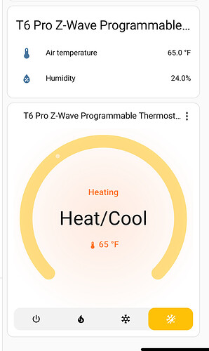

Good evening. I have a Honeywell T6 thermostat, and it is connected by Z Wave. I’m just trying to adjust the temperature using the app but don’t see a way to enable it. For comparison, when I installed some Kwikset 620 deadbolts, also Z Wave, I was able to lock and unlock them from the HA app. What do I need to do to actually control the thermostat through the app? Screenshot attached. Thank you!

That thermostat device does not appear to be configured correctly. It should have a small circular control like this you can adjust by dragging it around the arc:

So it did have that “slider”, but it was very small and “inactive” when I had it on “auto”. So if I moved it to “heat” or “cool” the behavior was as expected.
As far as the “lock/unlock” sorry, that was probably not relevant to this conversation as it was regarding my deadbolt locks…I only included it for an example of where I could actually interact with some Z wave devices. Thank you all for your help!
That small dot shows the current temperature. The large dot is the set point you can adjust.
Interesting that you can’t change the set point in heat/cool mode.
