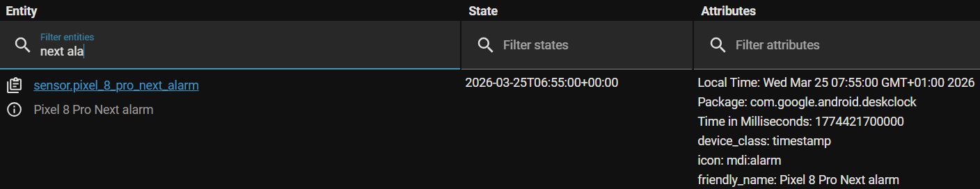

since some days the blueprint doesn’t work anymore. I’m on the beta android app it worked for 2 years without problems, the trace doesn’t show any start of this automation since some days, the sensor is enabled and the sensor is showing the correct next alarm, any idea how to start searching the problem?
Thanks for the suggestion, I have added the link to the description in V5. The trigger source is your alarm entity, check in the developer tools if the entity you configured in your automation still exist and it has a state with the next alarm datetime, like so:
I know I already checked this, it’s every day Mo-Fr 6:30 and this alarm is shown in the developer tools

Thanks for V6! Based on it, here’s a proposal that addresses some recurring requests. Fully backwards compatible: all new inputs default to the current behavior, so existing automations keep working without changes.
Changes:
  1. Allowed alarm apps (allowed_packages, optional, default: empty = all)
    Only runs if the Package attribute of the next alarm sensor matches one of the listed apps (e.g. com.google.android.deskclock). This prevents “ghost runs” triggered by calendar, reminder or automation apps that also register alarms with Android.
  2. Stale alarm guard (stale_guard, optional, default: off)
    At runtime it checks that the alarm sensor + offset still matches the current time (±90 s). If the alarm was disabled or moved after the trigger was scheduled, the actions are skipped. Implemented as a condition step with enabled: !input, so the user’s conditions input stays untouched.
