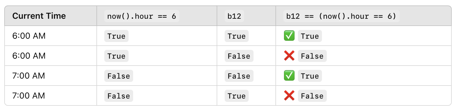

with the help of this table I think I understand your point about the template condition so it should only trigger the action(s) when B-12 & 6 are true OR when not-B-12 and not 6 are true.
I’m not sure why I got an action trigger with the 4th item in the table. I’ll test it again. Many thanks!
I reran the tests again and am not able to reproduce the problems either so we have a winner!!! I’ll try it out for real tomorrow morning. Hopefully I don’t sleep in!! Thanks for your help in sorting this out.
