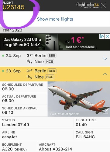

I want to trigger on the U25145 flightnumber.
For many flights the callsign equals the flightnumber, but for many others it doesnā€™t (to avoid ā€œcallsign confusionā€).
ADS-B only transmits the callsign though.
