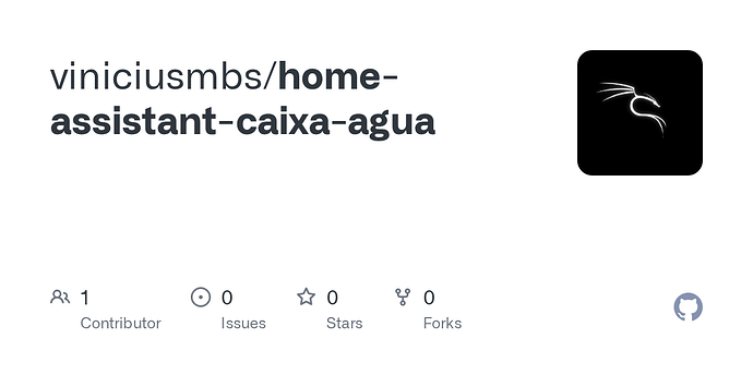

:open_file_folder: Project repository on GitHub
