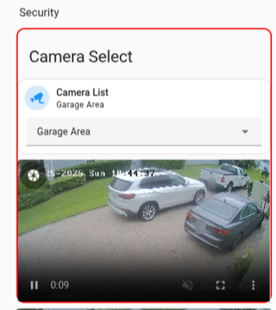

My long arduous journey is complete. Thanks to Ildar_Gabdulling for all the help and patient support. If I’d read his suggestions more carefully this may have been easier. Of significant help was a suggestion by Ildar_G to use a markdown card to troubleshoot. Doing this allowed me to see the output of my js templates. I could see if some code produced the wrong or undefined results, and if an object was returned instead of a string.
My goal was to automate discovery of the devices installed on my system and to avoid hard coding names. This solution finds all the objects in a given domain and lets me choose which one to display.
What I’ve ended up with is a method of using a minimize the space used up on a dashboard by selecting what a card is displaying. I did it primarily to allow me to choose which of my cameras would display on my main dashboard view, but it can work for climate, or groups of sensors.
There are three components:
  1. An automation script to load a drop down input_select with the device names / friendly names.
  2. A template using config-template-card that uses grabs all the domains (the domain is hard coded), then chooses the one that matches the drop down selection.
  3. An automation that on a state change of the drop down reloads the dashboard so the card will reload and display the selected entity. It will not do this dynamically as the card needs to reload to re-run the template. This requires loading browser-mods through HACS.
The following is for my cameras which are connected to a physical NVR.
  1. First create an input_select helper, what is loaded in the Options will be overwritten by the below:
- alias: "set camera names on startup"
  triggers:
    - trigger: homeassistant
      event: start
  actions:
    - action: input_select.set_options
        entity_id: input_select.camera_list
        options: "{{ states.camera | map(attribute='name') | list }}"
2, Next the card with the template, this is javascript.
type: custom:config-template-card
entities: states['input_select.camera_list']
variables:
  in_sel: states['input_select.camera_list'].state
  cam_sel_1: |-
    Object.keys(states)
    .filter(k => k.startsWith('camera'))
    .filter(k => states[k]
    .attributes['friendly_name'] ===
    in_sel)
card:
  type: custom:mod-card
  style: |
    ha-card {border: 2px solid red;}
  card:
    type: vertical-stack
    title: Camera Select
    cards:
      - type: custom:mushroom-select-card
        entity: input_select.camera_list
      - type: custom:advanced-camera-card
        cameras:
          - camera_entity: ${String(cam_sel_1)}
  1. Finally I set up to trigger browser-mod:refresh on a state change of my input select. I used Node Red for this using the events: state node for the trigger and the action to call browser_mod:refresh.
