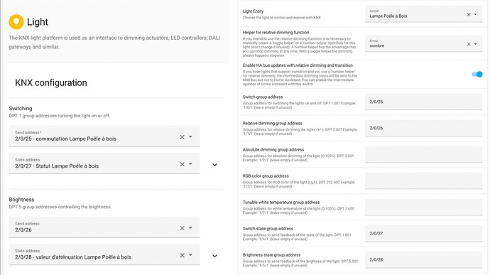

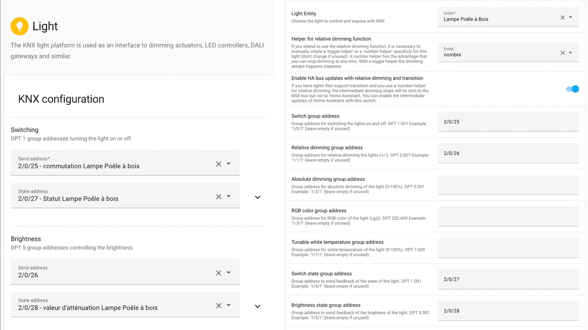

I’m fairly new to HA but I have a problem with this Blueprint.
Maybe it’s me who doesn’t know how to configure it properly, but I can’t control my relatively dimmable lights.
I did set the right address groups but I can’t figure out how to change the variation afterwards.
I tested it by removing the “Brightness” from my KNX light configuration, as I could see it wasn’t the right DPT.
I’ll probably need a little help to configure it.
I’m putting up a few screenshots to guide me if I need to remove just one little thing.
Maybe it’s silly, but I can’t figure it out at all.
Thanks to those who will see this

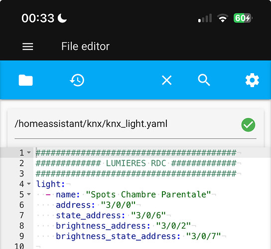

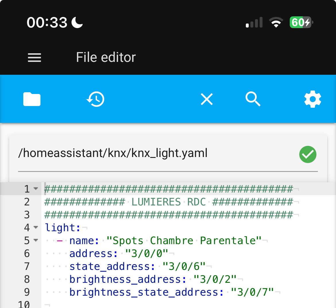

Salut,
Tri to add your Lights in knx.yaml.
Like the picture

Hello, are Group Adress correct? Do you have ETS to confirm? Is the connection between Home assistant and the ip/router interface ok?
The connection between my KNX IP interface and Home Assistant is active, and all the other non-dimmable lights are working properly. I just can’t modulate the intensity of some lights via HA that are already dimmable in my house using the buttons.
When I retrieved all the Group Addresses that were linked to the dimming parameter, I did a test from the group monitor on ETS to check that it was working and I did have parameters returning for example “Increase - 80%” or “Decrease - 30%” linked to DPT 3.007 and visually, my light was increasing and decreasing in intensity.
I think that you are missing the point of this blueprint. The goal is to use a KNX switch (ie. a wall push button) to control any light entity from Home Assistant. If you try to control a KNX light via a KNX switch, you should rather configure that only on the KNX side (via ETS).
You should never have to configure a KNX light to work with this Blueprint.
I now have a better understanding of my mistake and I had misunderstood the purpose of this Blueprint, and I think I’ve got a better idea of what I need to change in my configuration. I’m going to start again from ETS and redo the tests linked to my variation problem. Now that I’ve understood the real purpose of this Blueprint, it’s really quite incredible x) and will help me with other things.
Thanks for the explanation :+1:

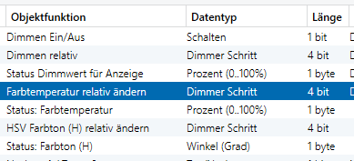

Hello, your blueprint looks awsome! Thank you so much.
Unfortunately, I miss the option to dim the color temperature and HSV-Color relatively. I’m using the MDT Glastaster II Smart | Serie .02 and it only supports relativ dimming (DP3.007) for TunableWhite (Status DP5.001 )and RGB/HSV (Status 5.003 ?!).
Don’t hesitate to ask for support. Do you need any traces or further information?
