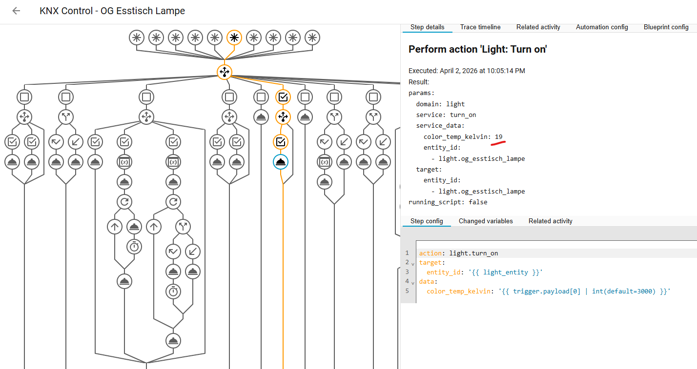

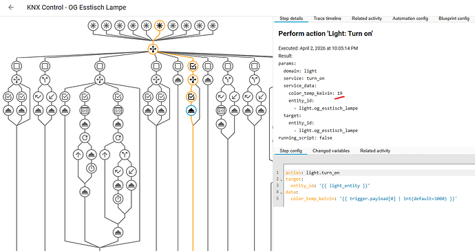

thanks for the quick response! in the group monitor I can see 5000K as the value (Payload 0x1388)
after reloading the blueprint and checking the trace the color was set to 19
I did some reading meanwhile and if I understand correctly the change to ‘trigger.payload[0]’ get’s the first byte of the payload eg 0x13 = 19
would it be possible to use ‘trigger.value’ property (requiring project data) or manually decode the 2byte DPT7.600 value as ‘256*trigger.payload[0] + trigger.payload[1]’ (avoiding the need for the project)?
It doesn’t need project data nor manual decoding. The telegram trigger can be configured with a type: "7.600" attribute to decode its value independently of project data.
For integer data that’s not that big deal, but for decoding Knx float this is very handy ![]()
https://www.home-assistant.io/integrations/knx/#triggers
Code updated again using trigger type for color_temperature (and brightness, but that’s not relevant except if I broke something :p).
Please let me know if it works now

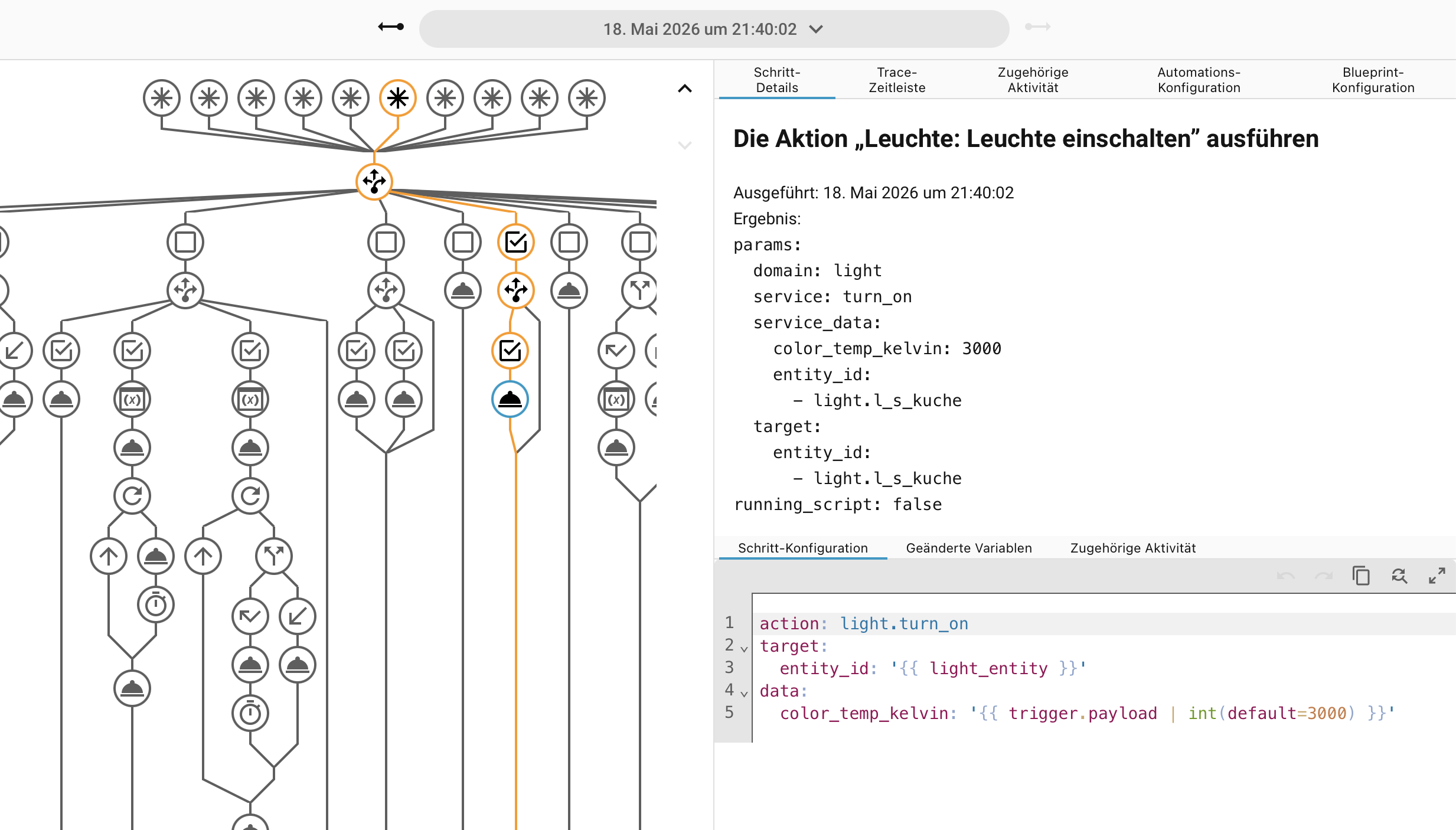

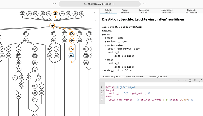

Hy guys, I am following your posts and updates for a while, and found out, that I have the same issue with tunable white as mentioned above. KNX send telgrams correctly, HA receives it as well, but the lamps do not react on sending. Just when I change the temperature directly in HA the lamps will do the right thing, but in KNX nothing happens. So is the correct version still that one from 1st of april? The posts about some updates are after that, so it might be the wrong version, but I found nothing else. Thanks a lot in advance! Clemens
Hi, could you post any error from the logs, and/or the trace log from the blueprint please ?
Hi Laurent, thanks for your answer, I hope I did the right log where you can see the problem. This occours when I try to change color temperature.
Thanks for the feedback.
You can try the new version from today. Note that I also moved the BETA as the main version as I had no problem with it at home for the last month
Wow it works!!!!! No idea what has been changed in the file from today, but everything alright now. Thanks a lot!!!
