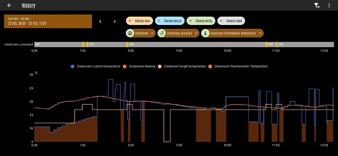

I’m getting some bizarre swings in current temperature from a couple of my rooms, causing the heating to fire or not when the temperature is just fine. Here’s one of the charts showing current temperature jumping from 12°C to 25+°C then back to actual room temperature. The chart includes the room presence and the temperature device the room heating is measuring from (the reddish line).
It often does this for a while then settles down, sometimes not. It’s a Tado system and if I check the Tado app, the current temperatures match what Home Assistant is telling me and the offset in Tado seems quite large. I’m wondering if this is a calibration issue?
Here’s the automation yaml:
alias: Cloakroom Heating
description: Controls heating in the Cloakroom only
use_blueprint:
  path: panhans/advanced_heating_control.yaml
  input:
    input_temperature_eco: input_number.heating_eco_temperature
    input_trvs:
      - climate.cloakroom
    input_temperature_comfort: input_number.heating_comfort_temperature_cloakroom
    input_force_max_temperature: input_boolean.boost_heating
    input_min_instead_of_off: true
    input_persons:
      - person.david_forrester
      - person.gem_forrester
    input_people_entering_home_duration:
      hours: 0
      minutes: 0
      seconds: 30
    input_people_leaving_home_duration:
      hours: 0
      minutes: 1
      seconds: 0
    input_presence_sensor: binary_sensor.cloakroom_occupied
    input_presence_reaction_on_time:
      hours: 0
      minutes: 0
      seconds: 10
    input_presence_reaction_off_time:
      hours: 0
      minutes: 5
      seconds: 0
    input_scheduler_presence: schedule.general_heating_schedule
    input_away_offset: 2
    input_away_presence_mode: true
    input_away_presence_ignor_people: true
    input_windows:
      - binary_sensor.cloakroom_window_contact
    input_mode_winter: input_boolean.cloakroom_heating_on
    input_temperature_sensor: sensor.h5075_b444_temperature
    input_calibration_key_word: offset
    input_calibration_generic: false
    input_generic_calibration_offset: 3
    input_calibration_timeout:
      hours: 0
      minutes: 0
      seconds: 30
    input_custom_condition_calibration:
      - condition: state
        state: "off"
        entity_id: input_boolean.we_are_in_bed
We have this blueprint running in 7 rooms. 5 of those room do not exhibit this behaviour. The rooms are all set up exactly the same :man_shrugging:

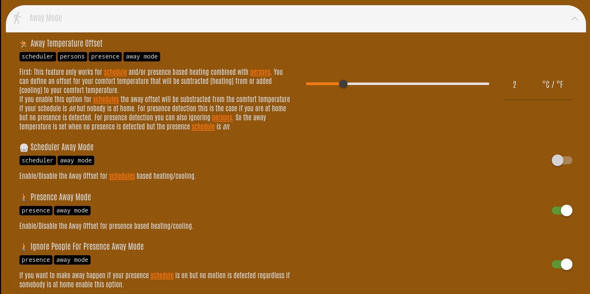

you can use the ā€œpresence Detectionā€ for that or the ā€œon/off automation optionsā€ and the ā€œwintermodeā€!
If you’re using presence detection, that’s what the Away Temperature Offset is for
ah great thanks guys i’ll take a look.
I presumed it was more for if the house was in away mode type situation not a per room. :slight_smile:
thanks for clarifying
