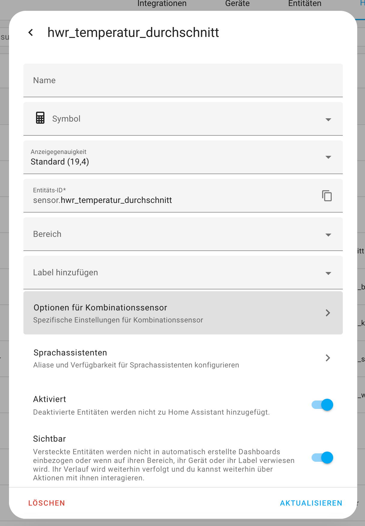

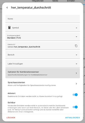

I’m trying to use an external room temperature sensor in Advanced Heat Control.
Since I have several sensors in the room, I’m calculating the average using a helper. However, I can’t use this as an entity. What am I doing wrong?

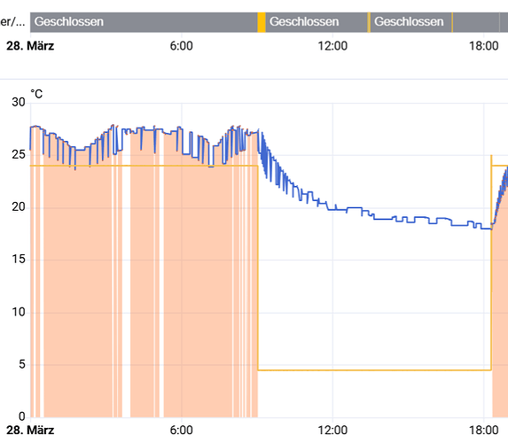

Unfortunately I do have problems with the window/door detection. As you can see on the screenshot attached, the Blueprint is decreasing the temperature of the thermostat properly, but after closing the window, the previous temperature will not be restored. This also happens when the legacy restore mode is turned on. The thermostat is from Homematic IP, model HmIP-eTRV-2. I’m looking forward to your reply.

A trace log would be helpful of the moment when eco should be set.
Calibration is active if you setup an external temperature sensor but maybe you have to setup some things. This should be helpful:

The sensor needs the correct device group (temperature). You can setup a template sensor intead of this average sensor. Ther you can define the needed attriubtes in the dialog. As a template you can use this.

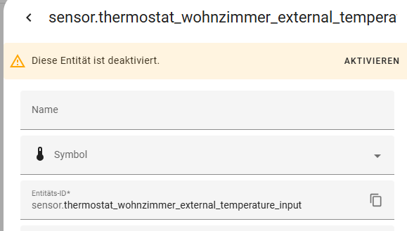

@panhans sorry for bothering you again. I have 2 issues; one is serious for me and happend also for other users using Aqara E1. [Link] I constantly getting this error message:
and searched in debbug which seems to come from external temperature sensor:
info 2025-03-31 13:43:58z2m:mqtt: MQTT publish: topic 'zigbee2mqtt/Fenster_Gaestezimmer', payload '{"battery":100,"contact":true,"device_temperature":18,"last_seen":"2025-03-31T13:43:58+02:00","linkquality":112,"power_outage_count":17,"trigger_count":0,"voltage":3055}'
info 2025-03-31 13:43:58z2m:mqtt: MQTT publish: topic 'zigbee2mqtt/Thermostat_Wohnzimmer', payload '{"away_preset_temperature":"5.0","battery":95,"calibrate":null,"calibrated":true,"child_lock":"UNLOCK","device_temperature":22,"external_temperature_input":null,"internal_heating_setpoint":19,"last_seen":"2025-03-31T13:43:58+02:00","linkquality":120,"local_temperature":20.1,"occupied_heating_setpoint":19,"power_outage_count":4,"preset":"manual","schedule":false,"schedule_settings":"mon,sun|0:00,21.0|12:00,17.0|18:00,21.0|23:59,21.0","sensor":"external","setup":false,"system_mode":"heat","update":{"installed_version":2590,"latest_version":2590,"state":"idle"},"valve_alarm":false,"valve_detection":true,"voltage":3100,"window_detection":false,"window_open":false}'
error 2025-03-31 13:43:58z2m: Exception while calling fromZigbee converter: Value: '2' not found in: [0, 1]}
info 2025-03-31 13:43:58z2m:mqtt: MQTT publish: topic 'zigbee2mqtt/Thermostat_Wohnzimmer', payload '{"away_preset_temperature":"5.0","battery":95,"calibrate":null,"calibrated":true,"child_lock":"UNLOCK","device_temperature":22,"external_temperature_input":null,"internal_heating_setpoint":19,"last_seen":"2025-03-31T13:43:59+02:00","linkquality":120,"local_temperature":20.1,"occupied_heating_setpoint":19,"power_outage_count":4,"preset":"manual","schedule":false,"schedule_settings":"mon,sun|0:00,21.0|12:00,17.0|18:00,21.0|23:59,21.0","sensor":"external","setup":false,"system_mode":"heat","update":
or here
error 2025-03-31 13:58:33z2m: Publish 'set' 'external_temperature_input' to 'Thermostat_Buero' failed: 'Error: ZCL command 0x54ef441000abdb9e/1 manuSpecificLumi.write({"65522":{"value":[170,113,19,68,18,124,5,65,16,0,21,141,0,1,157,27,152,0,1,0,85,68,250,0,0],"type":65}}, {"timeout":10000,"disableResponse":false,"disableRecovery":false,"disableDefaultResponse":true,"direction":0,"reservedBits":0,"manufacturerCode":4447,"writeUndiv":false}) failed (ZCL command 0x54ef441000abdb9e/1 manuSpecificLumi.write({"65522":{"value":[170,113,19,68,18,124,5,65,16,0,21,141,0,1,157,27,152,0,1,0,85,68,250,0,0],"type":65}}, {"timeout":10000,"disableResponse":false,"disableRecovery":false,"disableDefaultResponse":true,"direction":0,"reservedBits":0,"manufacturerCode":4447,"writeUndiv":false}) failed (ZCL command 0x54ef441000abdb9e/1 manuSpecificLumi.write({"65522":{"value":[170,113,19,68,18,124,5,65,16,0,21,141,0,1,157,27,152,0,1,0,85,68,250,0,0],"type":65}}, {"timeout":10000,"disableResponse":false,"disableRecovery":false,"disableDefaultResponse":true,"direction":0,"reservedBits":0,"manufacturerCode":4447,"writeUndiv":false}) failed (Timeout - 5993 - 1 - 83 - 64704 - 4 after 10000ms)))'
I checked for the entity as you described and it is “external”:
