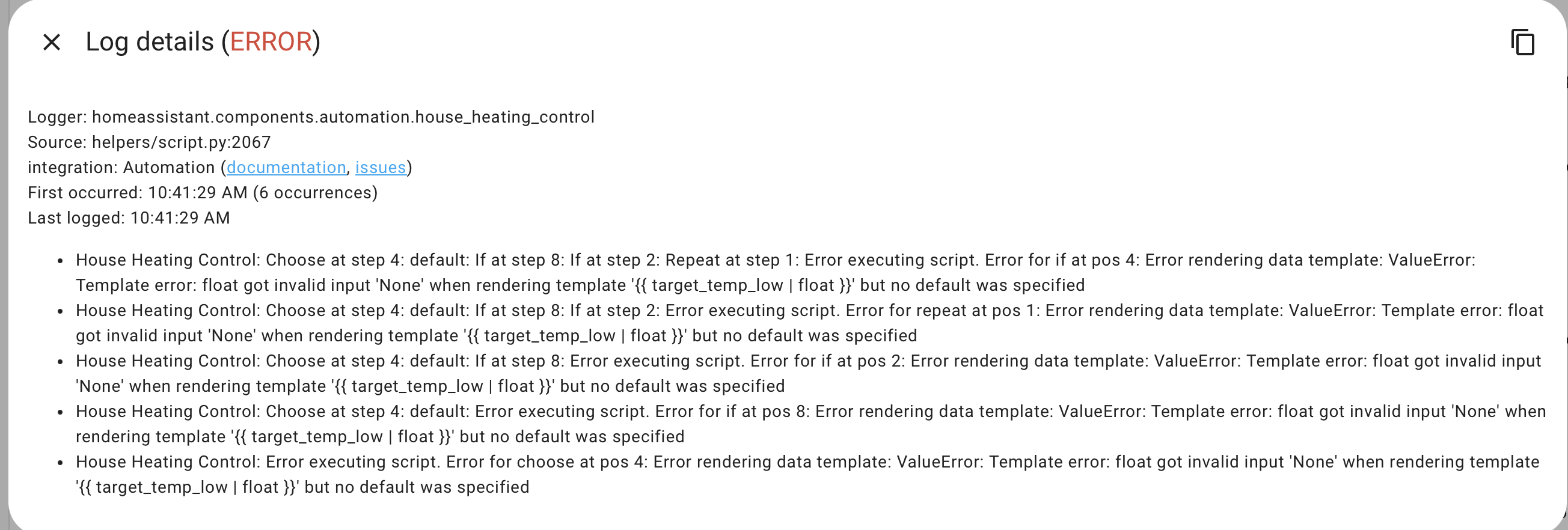

Hello everyone,
I’m having an issue with version 5.3.4 of AHC.
In general, the control system works exactly as it should – and I’m very happy with it. To disable heating during the summer months, I created an input boolean (switch). When this switch is set to “off”, all thermostats should be disabled so that no heating takes place (summer mode).
Unfortunately, this doesn’t work reliably. While the thermostats initially turn off when toggling the switch, they later turn back on by themselves – even though the switch remains set to “off”.
This is quite frustrating and goes against the intended behavior.
Does anyone know what might be causing this?
Attached is an example of the automation I’ve set up for the hallway.
I use Aqara E1 Radiators via Zigbee.
Thanks in advance for your support!

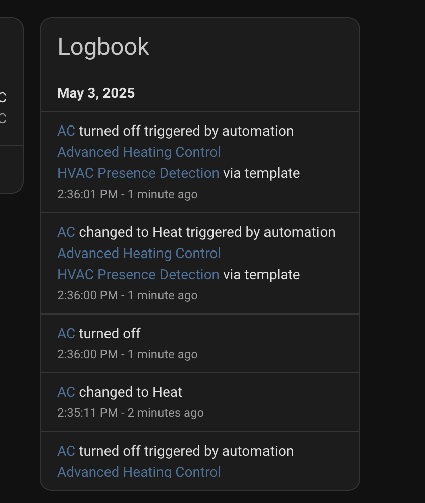

Hi.
As of the latest HA update I’m getting some really strange behaviour from the blueprint - I haven’t changed the config but essentially this is the summary:
Context: I have a three schedules with a schedule selector. ‘Winter’ schedule is currently selected. It had a scheduled on period between 11am-2pm - the script kept on turning off the climate entity.
I have presence detection (with schedule) enabled from 2pm-10:30pm. It is set to require no presence for an hour but keeps turning off the climate entity as soon as there is no presence.
Either way, the script today just turns off the AC and I am having to disable it now to use my AC at all!
Trace attached and some screen shots of the log entry for the climate entity, showing the presence scenario described above.
Not clear on the cause, all was fine until yesterday (when I installed HA updates), please help!
Thanks!
HA Logs and Advanced Heating Trace
I may have found the cause! I have a guest mode boolean set under the ‘Persons’ section even though I have no other person defined / configured.
That seems to be overriding everything - and showing on the AC entity log as the presence detection script. Am verifying and will confirm
