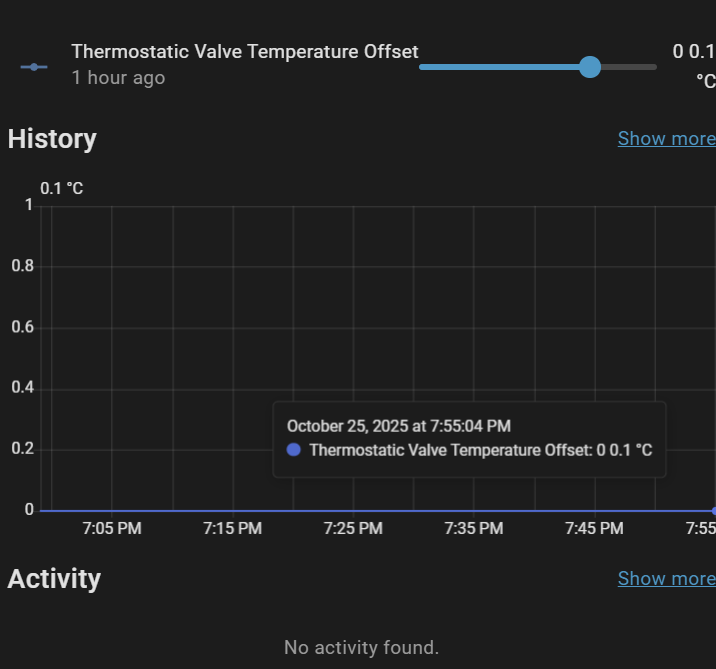

Can i use the “:old_key: Calibration Entity Key Word” also if not listed on the compatibility list ?
I saw if the zwave wave value the “Temperature Offset” and activated it
But i have a Problem je logic seams dont to work
I dont know why i never iut never trigged

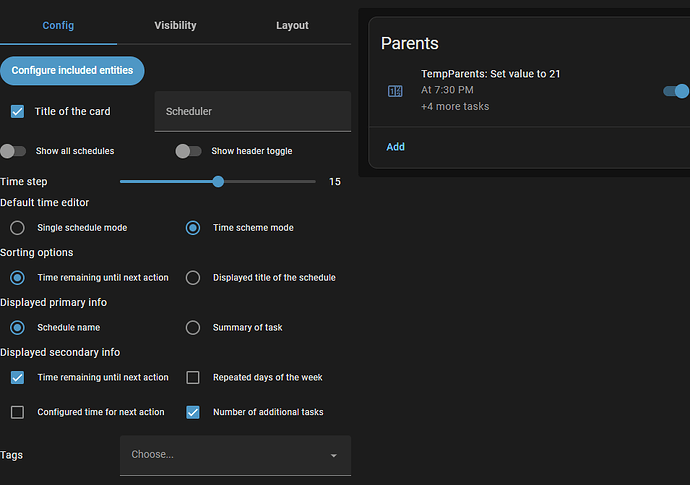

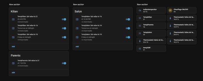

Hi, my automation trigger never, can somebody tell me what is wrong ?
The Confort TEmperature is set with
Here i have the on/OFF signal for heating, and it s ON
What is my Problem ?

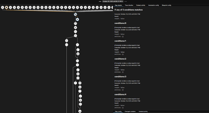

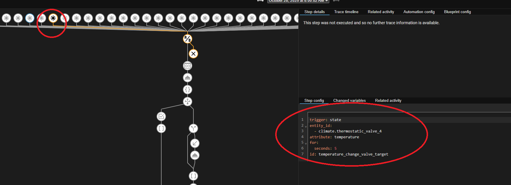

No Problem, i reuploaded the logs:
06:04 is manual triggered automation via “Run actions”
06:05 is time scheduled run via “Heating Schedule Adjustments”
trace automation.flur_eg_heizung 2025-10-06T06_04_16.195770+00_00.json
trace automation.flur_eg_heizung 2025-10-06T06_05_00.246218+00_00.json
Just tried to set this up and, well, we’re using Fahrenheit here. My regular temp is 68F but as soon as the automation triggered it dropped my thermostat down the 45F. That’s… bad.

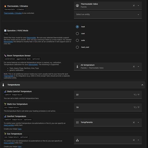

Somebody has an Idee what should i check ? why the logic never triged ?
not sure, what might cause your problem.

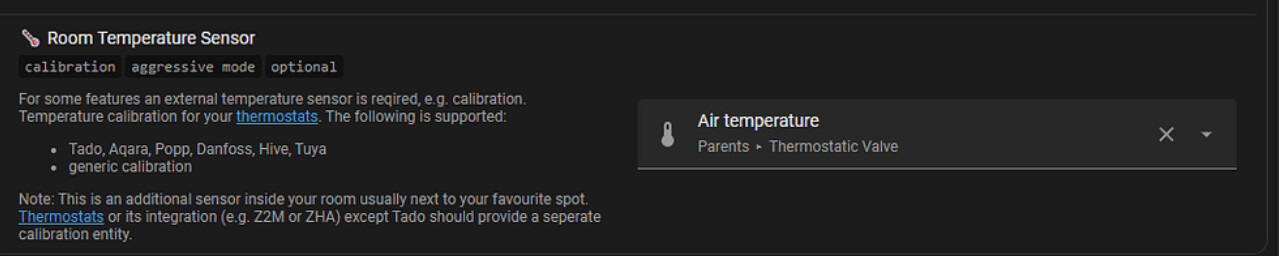

One thing i can see, that you seem to use a Thermostatic Valve for Room Temperature Sensor - this makes no sense. As its stated in the description. This is supposed to be an external Sensor for Calibration.
Also you might install the AHC state sensor as found in the opening post.
Maybe also check if AHC is running fine without your temp scheduler “TempParents” - for debug just use Static Comfort Temperature.
yes that was a mistake i deleted from the automation now thx :slight_smile:

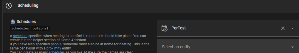

i added a schedule to see if he will trigger

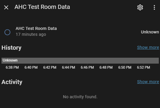

its called “AHC template sensor” in the first post of this thread.
Add it to your configuration.yaml add it to a dashboard and then you can see all the states of AHC - very helpful for debugging (in may subjective experience)
I made a copy and paste and received

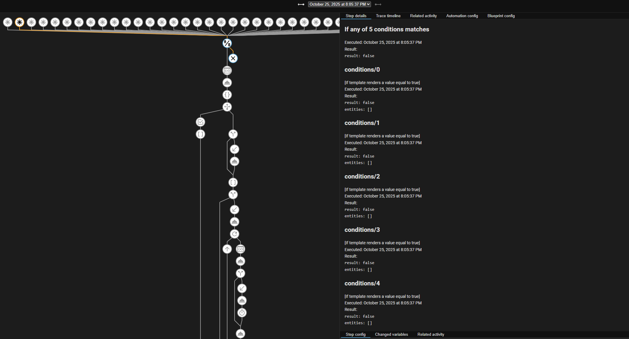

und here are the 3 Traces, perhaps u know how it works ?
Or i hope that @panhans can check it later
here the Traces:

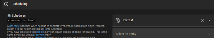

I don’t understand the schedule.
I’ve created four schedule helpers: one for 5:30 AM (morning), one for 8:00 AM (daytime), one for 4:00 PM (evening), and one for 9:00 PM (night).
I’ve also added an input boolean for presence control.
How can I integrate these schedule helpers so that the heating is adjusted to the desired temperatures based on presence?
Why have multiple schedule helpers? You can have multiple active phases in one schedule helper and link this to your heating automation.

@NotesTaker
With your configuration comfort kicks in when your office schedule is active. And the same schedle white lists the presence sensor. If you just want to use your presence sensor remove your schedules. If you want the presence senosor be recognized when you schedule is active set it as the presence schedule and leave the regular heating schedules blank.
@emmi89
You just need one schedule helper with your time slots. If you just want comfort heating when presence is detected, definde your schedule as presence schedule not heating schedule and set you presence entity.
