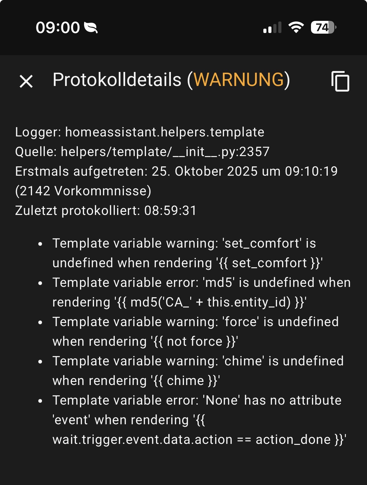

Hi. Thanks for the suggestion, but set_comfort also seems to be unavailable.

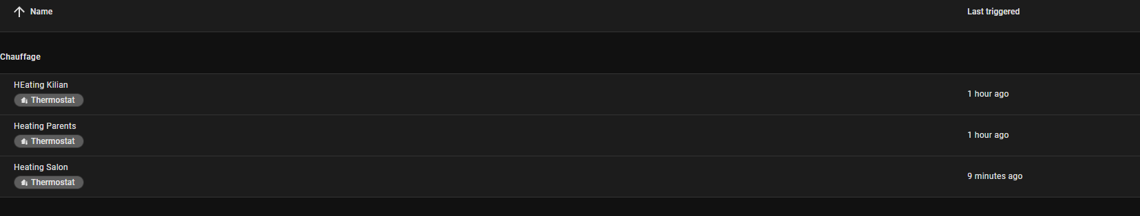

Yesterday i tried to add a schedule with a 30 min Confort / unconfort
and now the automation trigert
but i dont know why all 3 dont triggerd on the same time ( but they have same Schedule)
Here is the trace from today
https://limewire.com/d/2DlZJ#JzZ9CCjvfL

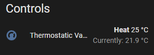

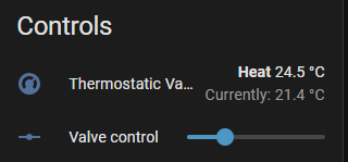

Here the Calibration is activated but I can t understand why he dont give the same setpoing for both
https://limewire.com/d/hu61s#9uJdVTxE9R
He calculate 24,5 and 25 but should ne the same because same automation

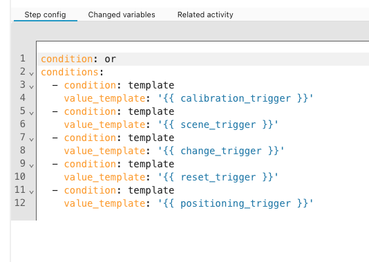

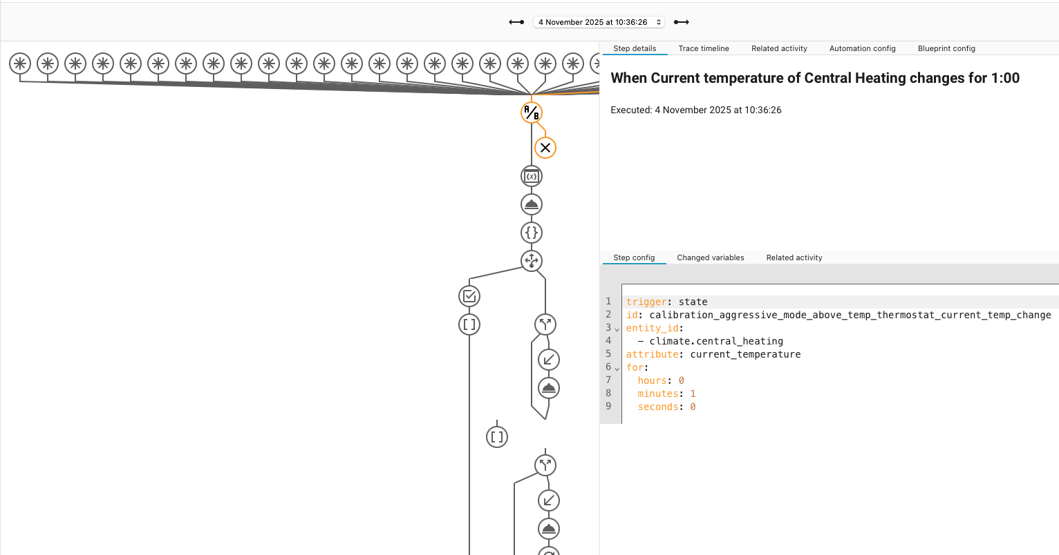

I’ve newly adopted the blueprint but I’m having issues getting the automation to trigger and run successfully, even with a minimal configuration. My config is shown below, can you help?
alias: Home -đŸ”„ Heating Control
description: ''
use_blueprint:
  path: panhans/advanced_heating_control.yaml
  input:
    input_trvs:
      - climate.central_heating
    input_temperature_comfort_static: 20
    input_temperature_eco_static: 19
    input_frost_protection_temp: 6
    input_adjustments: {}
The room temp is below the two nothing kicks in to bring the heat on. What am I overlooking?

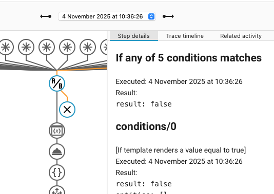

EDIT> I’ve done a little more digging and the screenshots below show the trace elements from the nearest actual run.
The automation triggers as a result of a temperature difference.
It stops as a result of all 5 conditions being false

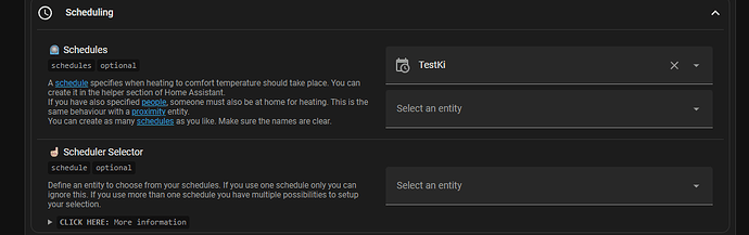

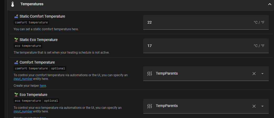

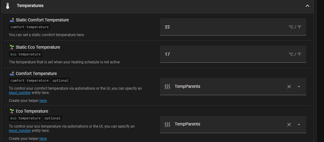

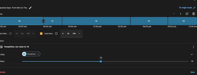

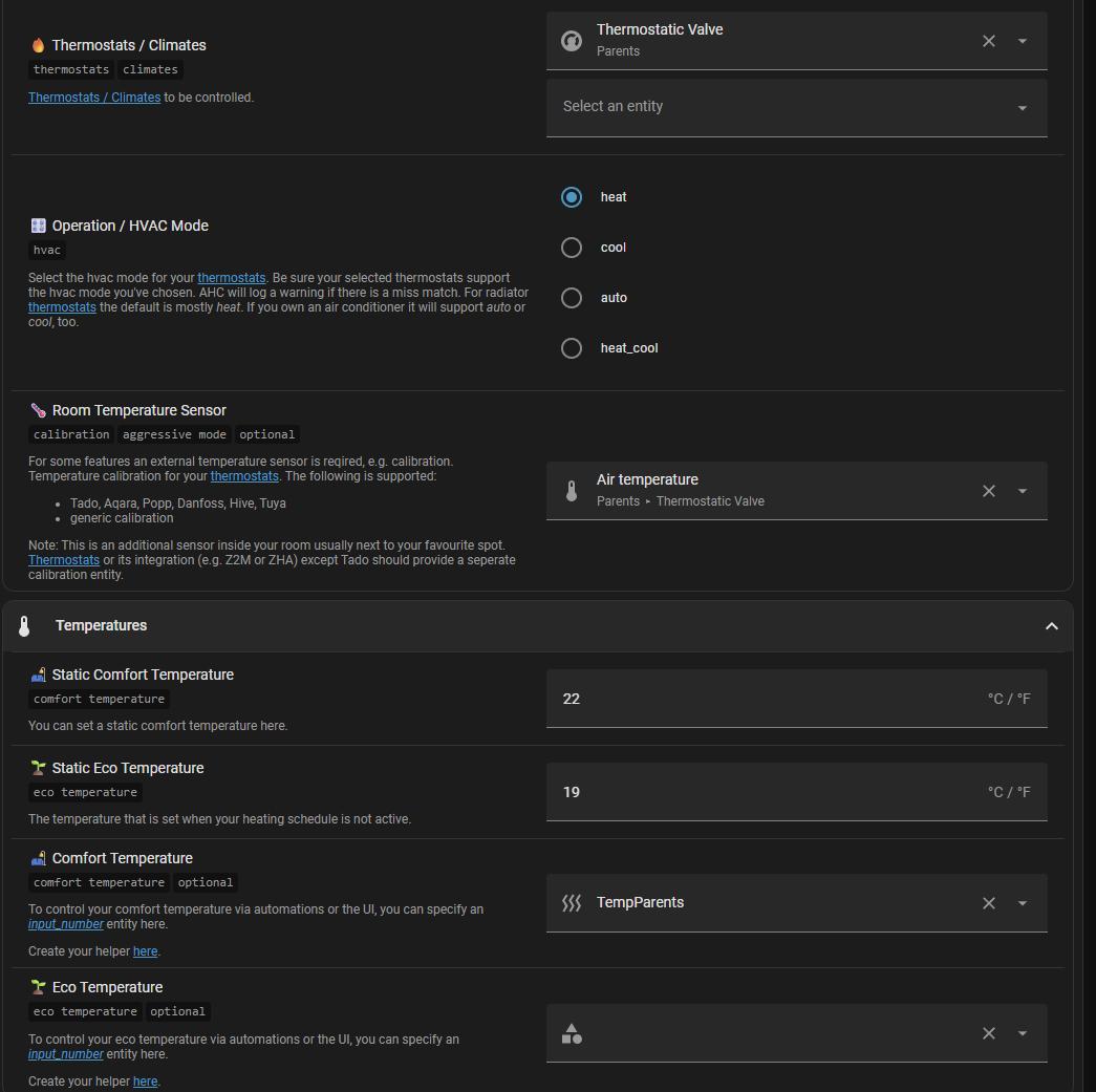

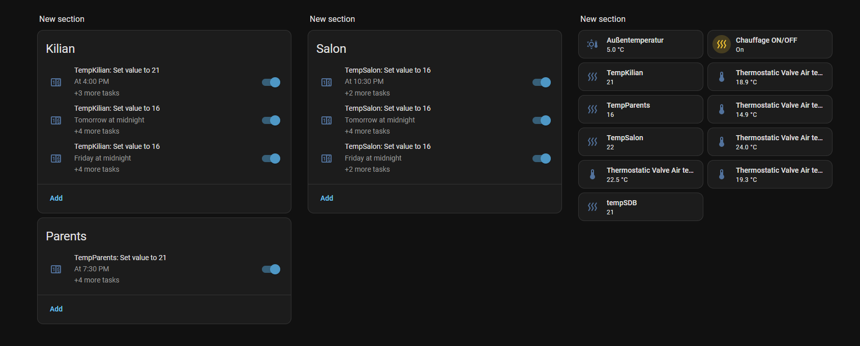

I have integrated several Scheduler cards into my dashboard to set different comfort temperatures according to different schedules (it was important that the family could directly change the setpoint or the schedule in the dashboard view using the Scheduler card).
Then I used this variable from the Scheduler card in the advanced-heating-control configuration as the comfort and eco temperature (since everything is managed by the Scheduler card planning anyway).
But the problem is that the automation doesn’t seem to have a trigger to execute (probably because I don’t have a presence sensor or a schedule in the automation).

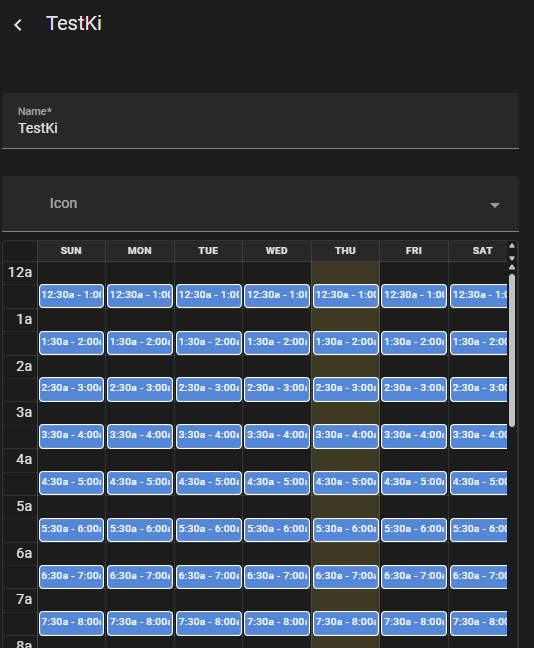

So I randomly tested adding a schedule that changes status every 30 minutes to see if the automation would work,
and it does—the automation is triggered.
Here you can see the link showing the solution with the on/off schedule every 30 minutes:
I could open the party mode or maybe for switches. so you can add all your custom schedules there. If one schedule turns on comfort kicks in. In your custom schedules you can edit the target temperatures (comfort & eco).
Then leave everything else blank in the automation configuration especially the schedule section.

When working with a Time Schedule, there is no separate eco/confort temperature because the different time slots and temperature settings are defined directly in the Time Schedule card, as shown in the image below.
It’s true that options like party or presence could also work if they are constantly activated by a bit, so the script might function in that scenario.
However, would it be possible to add a Time Schedule card option, for example under Scheduling? If enabled, the automation would know that the planning and temperature are managed by a Time Schedule card, and it could check every 15 minutes whether the comfort temperature has been updated.
In the screenshot above, “testKI” is only there to run the automation for 30 minutes. An option somewhere that would allow triggering the automation every 15 or 30 minutes to check if a new setpoint temperature exists would make it possible to remove this table.
Another possibility might be to add this option directly under Temperatures below: If Time Schedule Temperature is enabled, then it only needs to set the variable from the Time Schedule card, and the program knows it should check every XX minutes whether the temperature has changed.
The automation triggers automatically when the value of the eco or comfort entity changes. There is no need for time based triggers. You also can setup an input boolean as a fake presence sensor or guest mode and with your schedule you can toggle this input boolean and set your temperature entites as you like.
But as you can see on the trace automation don’t triggers automatically after a new temps value, thats why i force with this 30min triggers
Yes at least you need a person, guest mode, presence sensor, proximity, ect. that toggles between comfort and eco.
If you don’t set at least one option the automation only handles calibration and window detection.
As I said get rid of your TestKI schedule and set an input boolean for the presence sensor that toggles between comfort and eco with help of your time schedule that set the temperatures to the temperature entities.
I could also whitelist switches so you’re able to set your time schedules directly in the automation.
As i said before I dont need that toggles between comfort and eco. Ther is only “temproom” value in the “time schedule card”
If I set a constant value of 1 for presence (since I don’t need to switch), will the automation check every few minutes whether the comfort temperature has changed? (as i said befaore the eco temperature is not used)
Here I didn’t understand. As I mentioned before, the goal is for the family to be able to change the schedules and temperatures directly in the dashboard without opening anything else like an automation.
From what I understood, it should rather be that the automation checks the comfort temperature from time to time (for people who don’t need a switch eco/confort).
Of course, in addition to my time schedule, I use the party mode to set a slightly warmer temperature (overriding the temperature defined in the time schedule card).

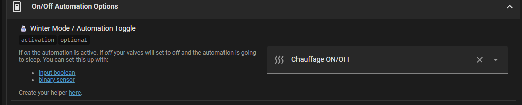

In addtion i use also for exemple Winter Mode / Automation Toggle
 ousdide temp
sorry if it was not clear that i only use confort temp
Then just set an presence sensor / toggle that is always on.
No, but the set temperature change triggers the automation.
Just set a dummy entity that is always on as presense sensor and your comfort temperature entity and you’re good to go.

I sometimes have the problem that the heating thermostat keeps heating even though the desired temperature has already been reached. AHC then just doesn’t turn the thermostat down any further; or maybe even shuts off completely. Does anyone else have this issue?
Also: Is there already a solution or a way to control the HomematicIP thermostats manually, or will that not/never be possible?
