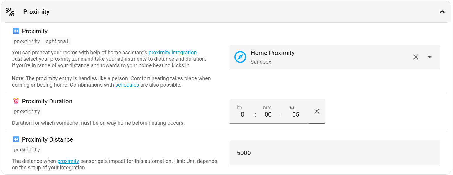

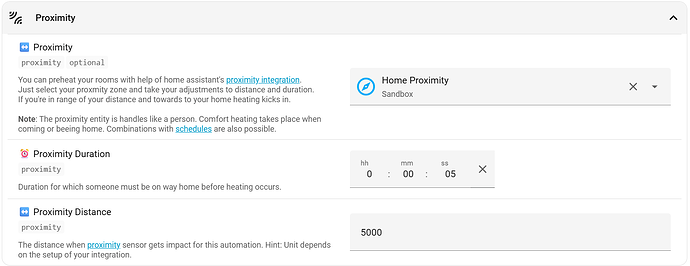

I am running in to an issue with the Proximity feature whereby it doesn’t seem to trigger until I (or someone else) is physically Home.
I have setup a zone called ā€œHomeā€ using he Proximity Integration which runs a couple of miles from my house.
I have the Proximity Duration set to 5sec.
And the Proximity Distance is 5000.
The automation does not seem to trigger pre-heating of my house until I physically arrive home. I assume this is related to connecting to Wi-Fi to signal a presence.
Any ideas what I am doing wrong?

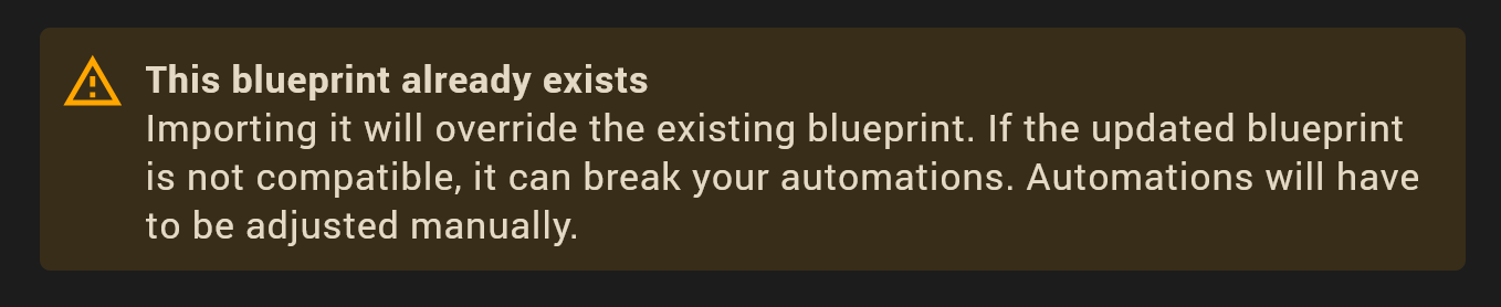

Just wanted to import the new Version 5.4 with the breaking change.
There is a little warning while importing:
Now, I am wondering how to import the new blueprint Version 5.4 (which has the same name as Version 5.3) besides my existing AHC automations. So i can switch between them until everything works fine.
In other words - i do not want the new AHC blueprint to overwrite my existing AHC automations.
Is it enough to ā€œTake Controlā€ over the existing AHC automations?

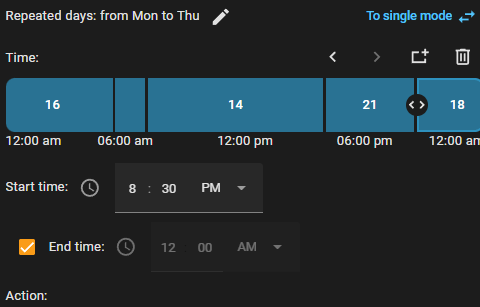

Hi the problem with this solution is that you are limited with 2 Temparature :confused:
The soltuion dont work for peaple with a timeline with 3 Temperature like that
Would be better that the bluprint can check all 15 min the new Confort value
Also if you give a new Confort value on your dashbord it will be only checked after a switch timeline between eco / confort
Would be nice to be have the option to give that he have to check every 15min if there is a new Confort value
Preheating should happen if someone of your proximity sensor is in a range of 5000 and minimum 5sec towards that zone. Could you check the history of your proximity sensor if it gets the state towards?
I think you have to rename the old version. Just have a look at the top and set some prefix to its name for example.

Why you are limted? You can set the comfort entity and eco entity as you like with the schedule integration.
As I said this is not needed, since the automation gets triggered whenever the target temperature change but not if its in eco mode and the comfort temp gets a change since this has no impact to the actual logic.

My automations do have a different name (with a prefix)
Renaming the old blueprint does not work.
Maybe there“s no way doing what i“d like to do.
it had its downfalls when you gave new versions of the blueprint a new name (no more re-import) now we can re-import the new version — which everybody seemingly just did.

Ah, sry. You have to copy the blueprint file with a new file name, clone your automation, open it in yaml mode and link the referenced blueprint to the renamed copy.
Then you can simply update the blueprint and you are able to fallback.
