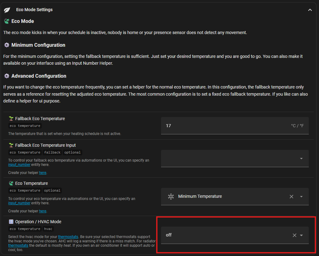

Hello. Thank you for this great automation. Can I ask why the “Off instead of Eco” setting has been removed in the latest version? Now my ACs are permanently on at all hours, instead of turning off when the schedule or presence changes. Unless there is another setting I am missing?
Thanks again.

Ok, thanks. I need to update the whole documentation as well.

As I mentioned in the changelog and again in the first post :wink: :
I can’t remember this. Maybe he uses a custom selector or another blueprint?
