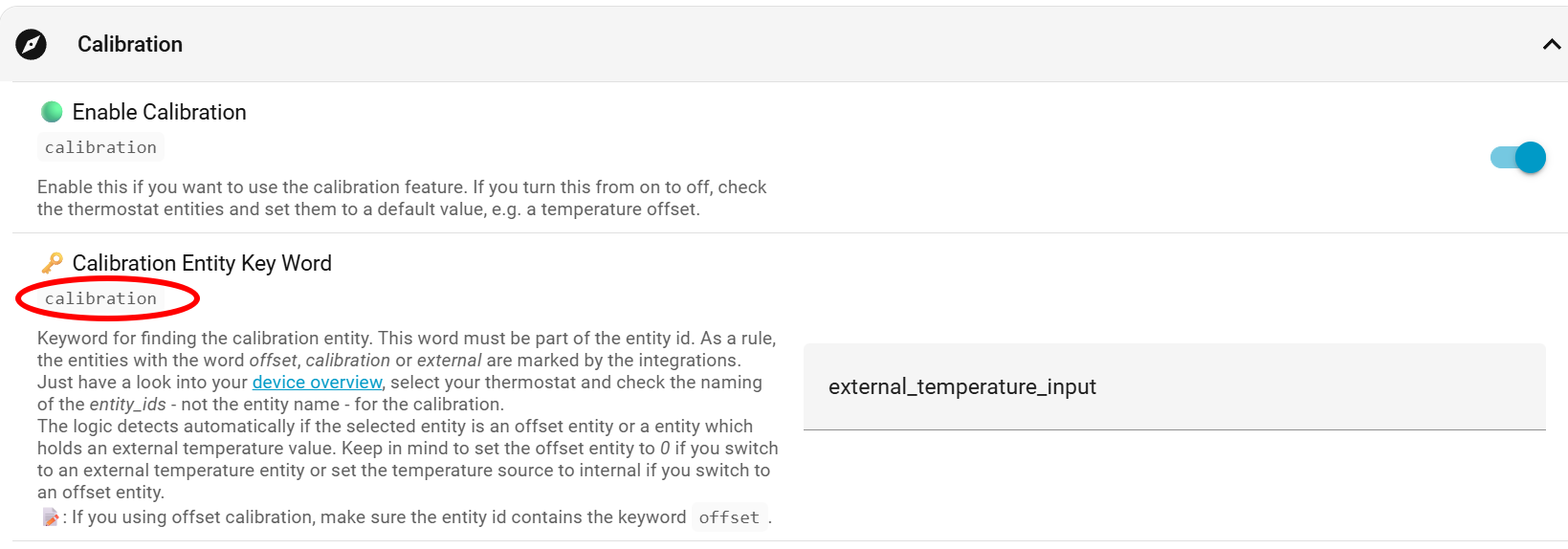

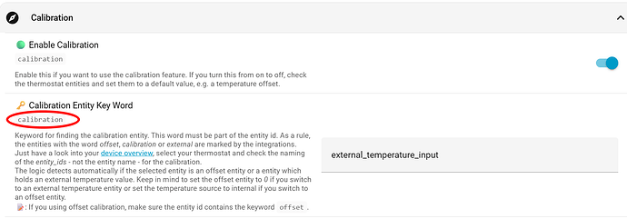

Oh My God. For the first time ever, all my thermostat temps are 100% aligned with external Thermometer readings. This is what I wanted from the very beginning, I spent so many hours working on this and one keyword mentioned by you fixes everything.

Yeah, I see two places for clarification:
  1. Inside the Blueprint itself. It does refer the need for a targeted key-word for internal calibration, but completely omits the same for external. In my naivity, I had assumed this means you switch calibration off when going to external temp:

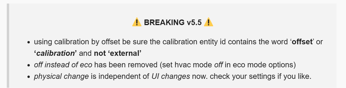

  2. At he very beginning, there is this box about changes to v5.5. Adding the below bullet point would help:
  • using calibration by external temperature be sure the calibration entity contains the word “external” or “external_temperature_input” and not calibration.

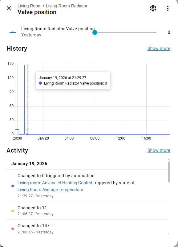

I’m using latest version (5.5.6) and I see some weird behavior. I have a radiator Comet COZB0001 (Eurotronic COZB0001 control via MQTT | Zigbee2MQTT) which supports 2 TRV modes (1 aka manual and 2 aka auto) and I can set the valve position when it is on 1. So I have set first the eco mode to be off but I see that it goes to Auto HVAC. Additional when it get triggered by the conform temp. it goes to Heat HVAC (as I set it in HAVC settings) but the valve position remains to 0. The keyword I set it to “valve_position” (entity id: number.living_room_radiator_valve_position), timeout default (20min).
The radiator itself when it is on Auto/eco is still slightly warm but on the Heat is goes more which someone is says normal but I’m not sure where is the valve.
Any help?
Yes, maybe it needs a modifier in the adjustments to disable the physical sync feature temporarily. This shouldn’t happen. I will test it and fix it if I can.
Did you see the state of your valve positioning entity or is it write only? Try to decrease the timeout, but with a temperature change the valve position will be forced regarding the timeout.
I’m not sure what you mean with state or write only, so I can provide screenshots
Changes to position yesterday to 11 and 147 where manual to test if works. I also try to play with the temperature difference but didn’t help.
Could you reimport the blueprint and test again. Didn’t know there where valve positioning entities with values up to 255. This should now work with your entity, also with negative values if there are implentations like that.
