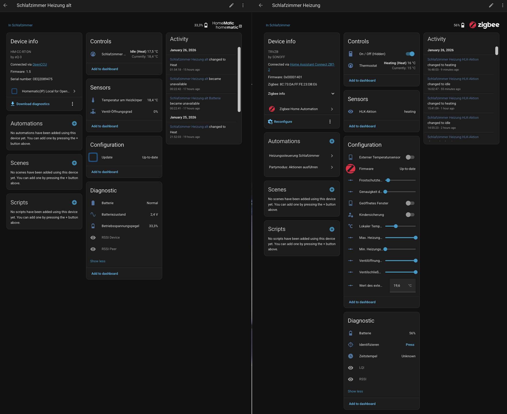

I actually bought one Sonoff TRVZB and was very amazed by the reasonable pricing and the build quality. However I think I am missing functionality. I’ve asked in another topic to not hijack this thread:
I’ve attached screenshots and a 1:1 comparison. I thought this may be interesting to other home automators.
If anyone has an opinion on what is a good TRV please answer in my post and thank you :slight_smile:
