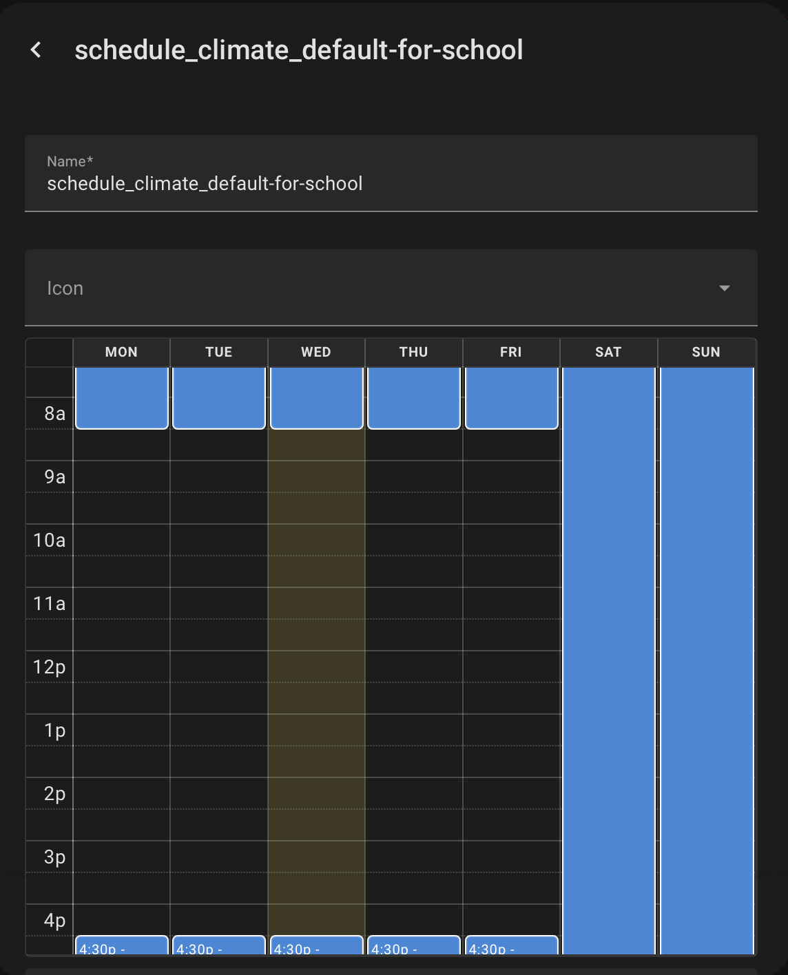

Hi @panhans !!
long time no see :slight_smile:
Your blueprint works like magic. I’m loving it more and more every day.
There is however something that just now has thrown me off balance when I thought I had fully grasped how the whole blueprint works.
I work from home most of the days, and when I leave Home, I see that the system reacts and sets the target temperature to Eco. And this is beautiful. Full Stop :slight_smile:
As I was saying, most of the days work from home.

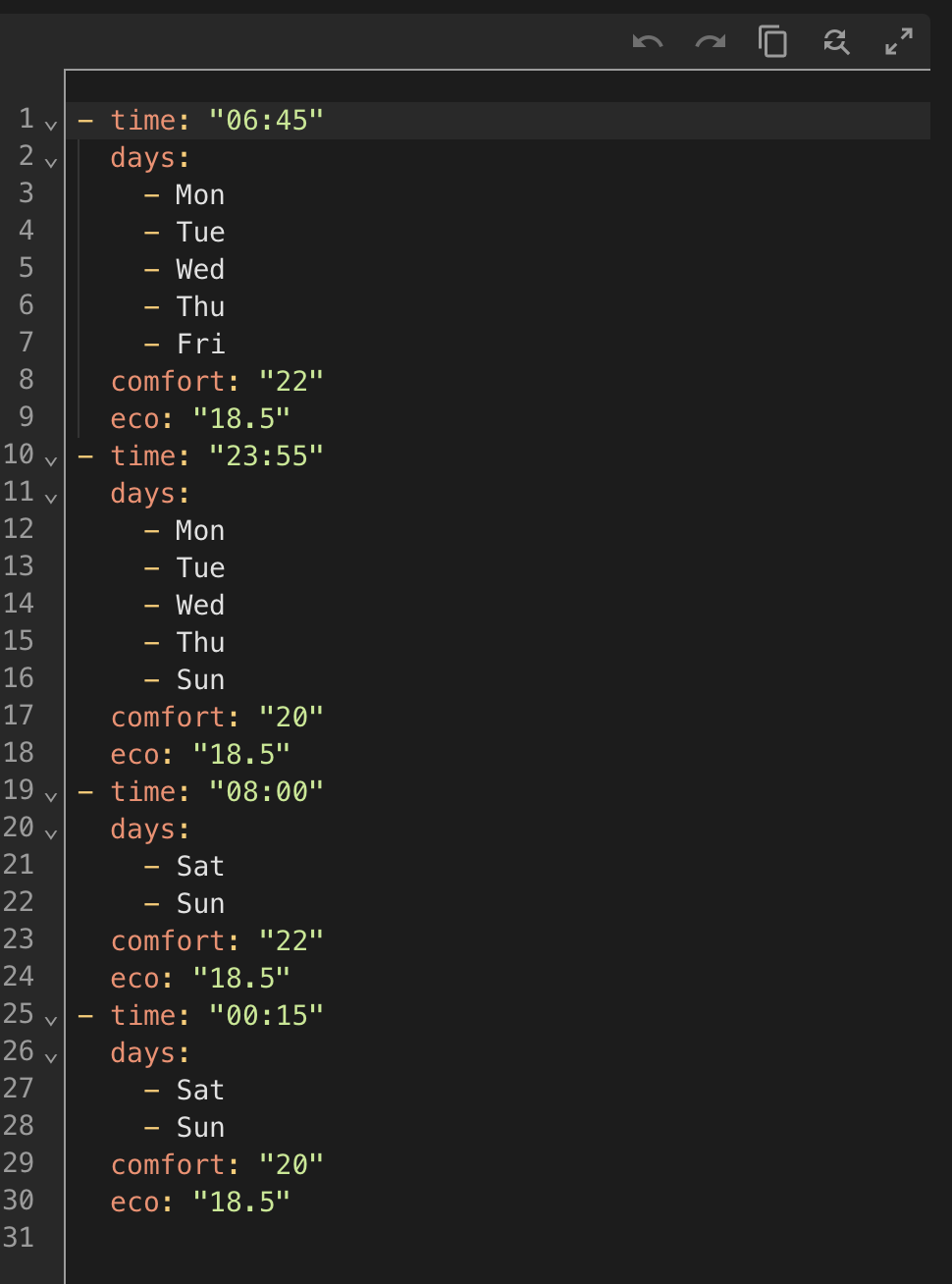

Long ago (2 years ago) I defined an input text to hold my different schedules, but I don’t typically change the schedules and it is always set to my “default heating schedule”. I thought I would be using this feature, but I simply forget to change the schedule when it is bank holiday
 Assume that I have not transitioned for months from my default schedule to the rest of the schedules that I have
My default schedule looks like this:
Note that I created this schedule long ago when I was not even working for my current employer, and my previous employer did not fancy WFH at all, which means that I would need to go to the office every day (hence the schedule that you see). And I have not switched schedules in years!
My recorder is configured to hold a few days span of data, but enough to proof that the active schedule has been indeed the default one (which corresponds to the image above).

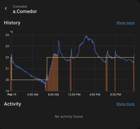

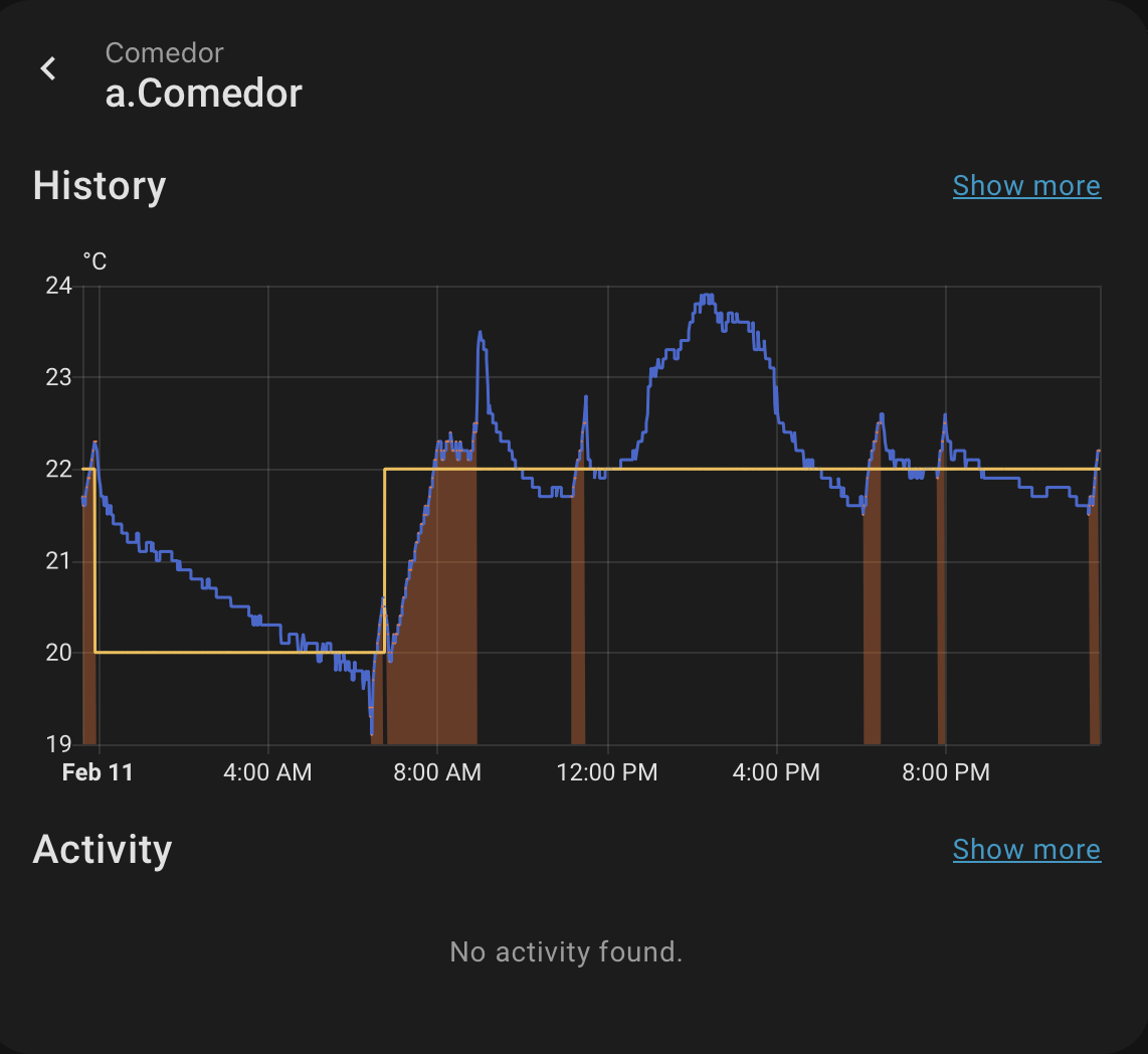

My heating plan looks like this:
And today, the temperature has actually mimicked the heating plan
If my understanding of the blueprint is correct, what I see is not what should be expected from the blueprint right?
Meaning that,
  • even if the heating plan mandates taget temperature to be confort 22 and Eco 18.5 starting at 8am in the morning
  • even if I was home the whole day (presence = home)

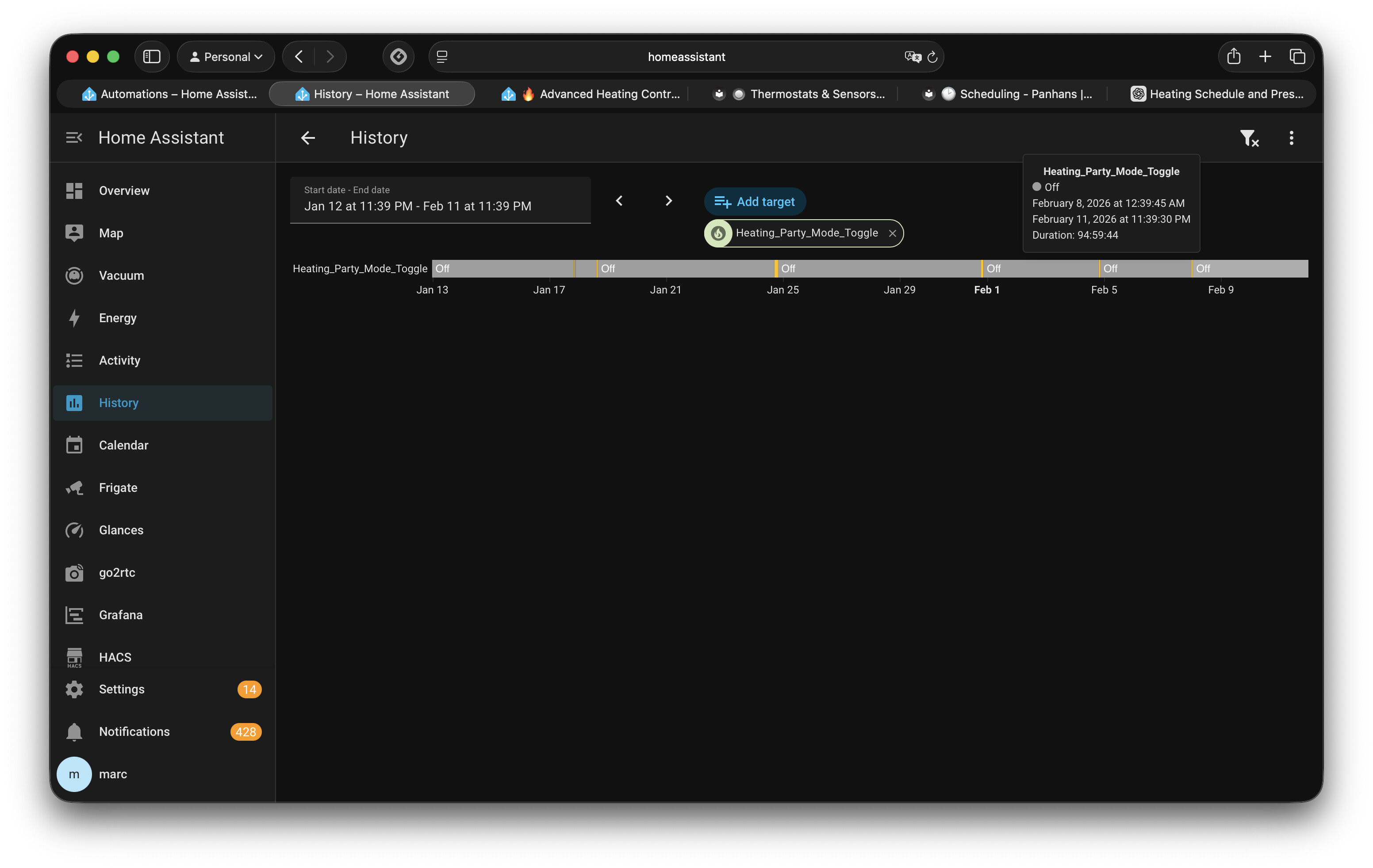

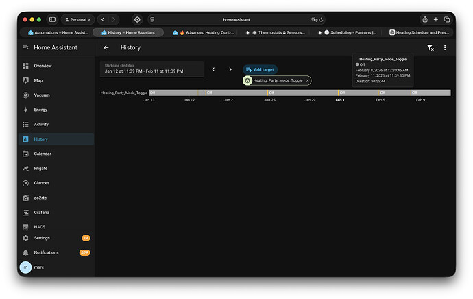

  • knowing that party mode is set to off (see below)
given that the schedule that I have forces Eco from 8:30am to 4:30pm from Mon to Fri, target temperature should have had to be Eco within that timeframe despite the rest of the variables above, right :question:
Presence can’t override the schedule, can it?
I’m very curious to know what I’m missing!!!
Cheers!

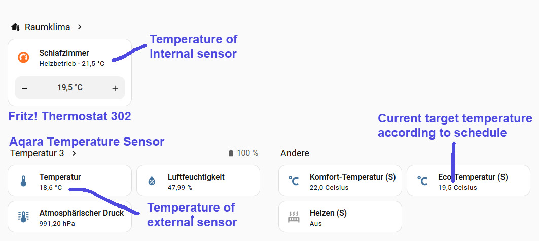

I installed your blueprint (v5.5.7) yesterday on my HA instance to automate my heating system. As a first test, I set up an automation for my bedroom (Fritz! Thermostat 302, external Aqara temperature sensor). Since the thermostat does not provide calibration entities I activated ‘Generic Calibration’ with
  • calibration timeout: 1min
  • minimum temperature difference: 0,2 °C
  • step size: auto
  • generic calibration:
  • generic calibration offset: 5 °C
As far as I understand the documentation, the automation will determine the difference between the internal sensor of the thermostat and the external sensor and add this difference to the target temperature of the thermostat. Right?
However, the room does not reach the requested temperature although the external sensor measures a temperature that is below the requested one. Also, I cannot see any automatic adjustment of the target temperature, neither in HA nor at the phyiscal thermostat.
As can be seen, the requested temperature (Eco) is set to 19,5 °C. The temperature measured by the internal sensor is 21,5 °C, the external sensor measures 18,6 °C. The target temperature displayed both in HA and the physical thermostat is 19,5 °C. The thermostat is closed.
I would have assumed that the automation adds about 3 °C to the target temperature since this is the difference between internal and external sensor so that the target temperature would become 22,5 °C and the thermostat would open again to increase the room temperature.
Do I miss something here? Is my understanding of the generic calibration correct and, if yes, why does the automation seem to ignore the temperature measured by the external sensor?
Thanks a lot for your help.
Regards, Sven

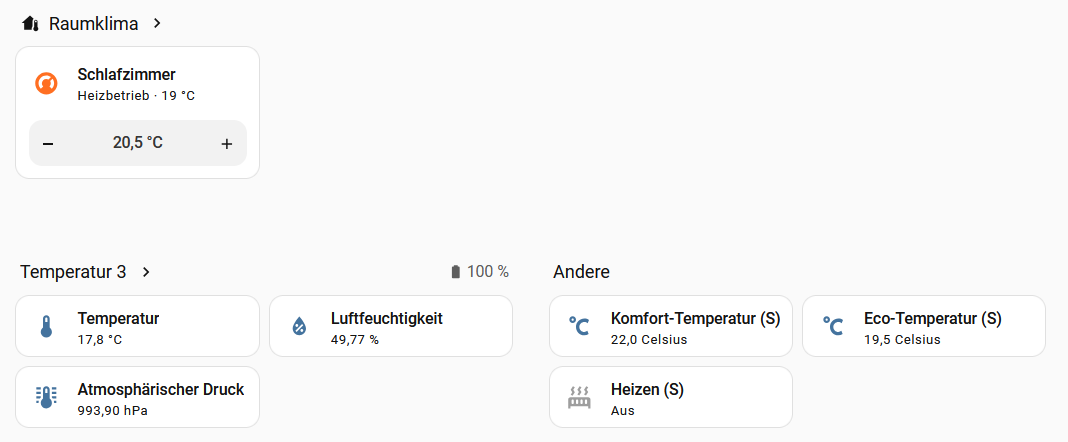

Oh boy, the problem sat in front of the computer as it is often the case :flushed:. I checked the automation again and noticed that I had put the entity of the internal sensor of the thermostat into field Room Temperature Sensor instead of the external sensor (very similar entity IDs). No wonder that the automation thought that were was no difference between the internal and external sensor and did not adjust the target temperature. After I corrected the configuration, it looks like this:
The difference between internal and external sensor is 19 - 17,8 = 1,2 °C and the automation enhances the target temperature from 19,5 °C to 20,5 °C accordingly. Now, everything seems to work as intended :blush:.

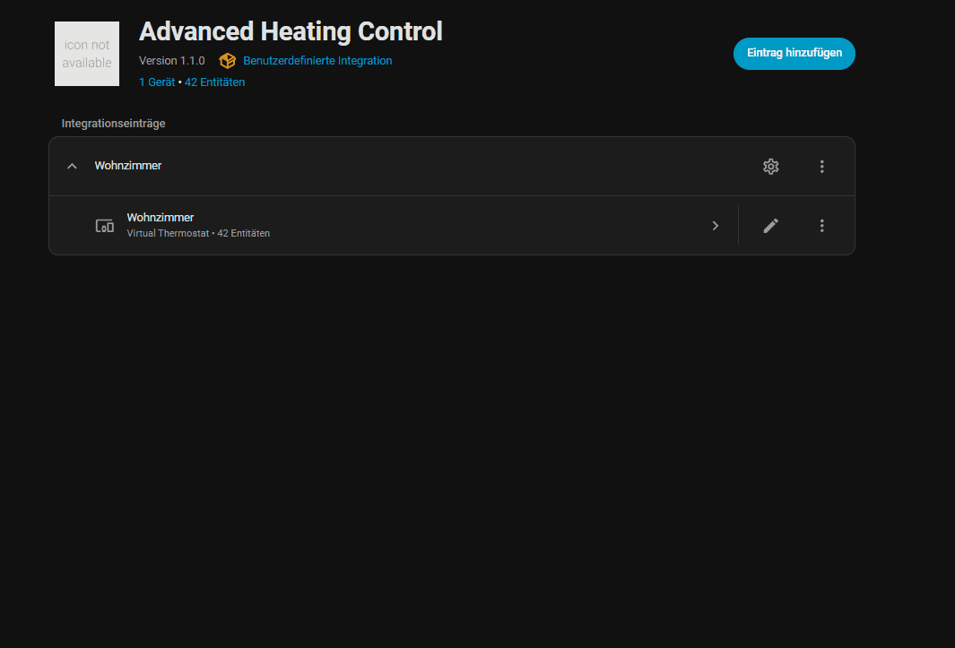

Looks like an Integration based on ahc blueprint :wink:
I’m a little curious about that. Feel free to share the repo if you like. :wink: This was always my plan but never got into this. I’d just wrote a little rest based integration for fetching data of my energy provider. But instead of the default integration setup I had some ideas about fully customizable view for schedules ect. like Alarmo did. Lets say a completely independet dashboard.
A repo is currentlly not existing, is still on beta, but my functions are working great.
You can Test it later :wink:
Yeah, i also think about it to do it like alarmo :+1:t2:
