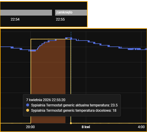

Hi there! I’ve been using **AHC for a while now—huge thanks for this project, it’s been a lifesaver!
I ran into a bit of a cooling issue yesterday and wanted to check if this is expected behavior. According to my logs, my window entities briefly became ā€œunavailableā€. This triggered the automation to lower the temperature (which is correct), but unfortunately, the temperature did not restore to its previous state once the entities became available again.
Are there any recommended ways to ā€œbulletproofā€ the blueprint against these types of sensor dropouts?
Thanks in advance for the help!
