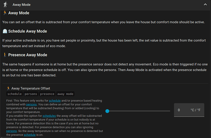

Hey there,
Is it possible to change Off If Nobody Home to Eco If Nobody Home?
I don’t want 5 degrees in wintertime when nobody is home.
Thanks
@NebuNC2
I don't use Away Mode, but it seems possible to adjust the offset temperature. Here is a screenshot:
