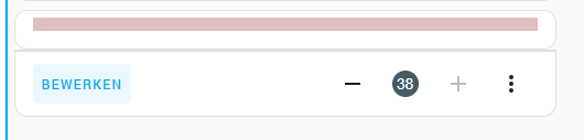

I installed the 3 github cards and pasted the code (after creating 2 helpers) but I only have a bar with no text and info
got it working

I’m also having trouble getting this to work. I only see the bar.

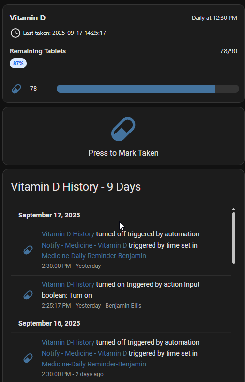

In case it helps others. I am still fiddling with this and have multiple setup. I have taken control of the automation so I could edit. Unfortunately, it is only popping up on my phone for my initial setup. I am guessing it is scripted the same and needs to change, but I have not yet had time to rescript. In the short term, I added a button that toggles the input boolean off. I have a 2nd automation that decrements the counter and modifies the adherence input/date time to properly record when it was last taken. This was not working in the original blue print. I would love to change the date time format on adherence (last taken) but haven’t gotten to modifying yet successfully. See below for an example dashboard for a vitamin (this one not hitting phone - so button for “taken”.
Hope this helps someone else.
