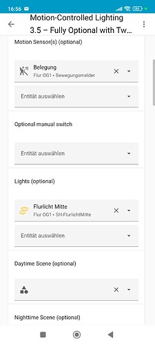

I would like to use it but it’s not working - no lights are going on.
There are some issues with this in gitbub but the developer does not respond.
So this blueprint is now trash.
