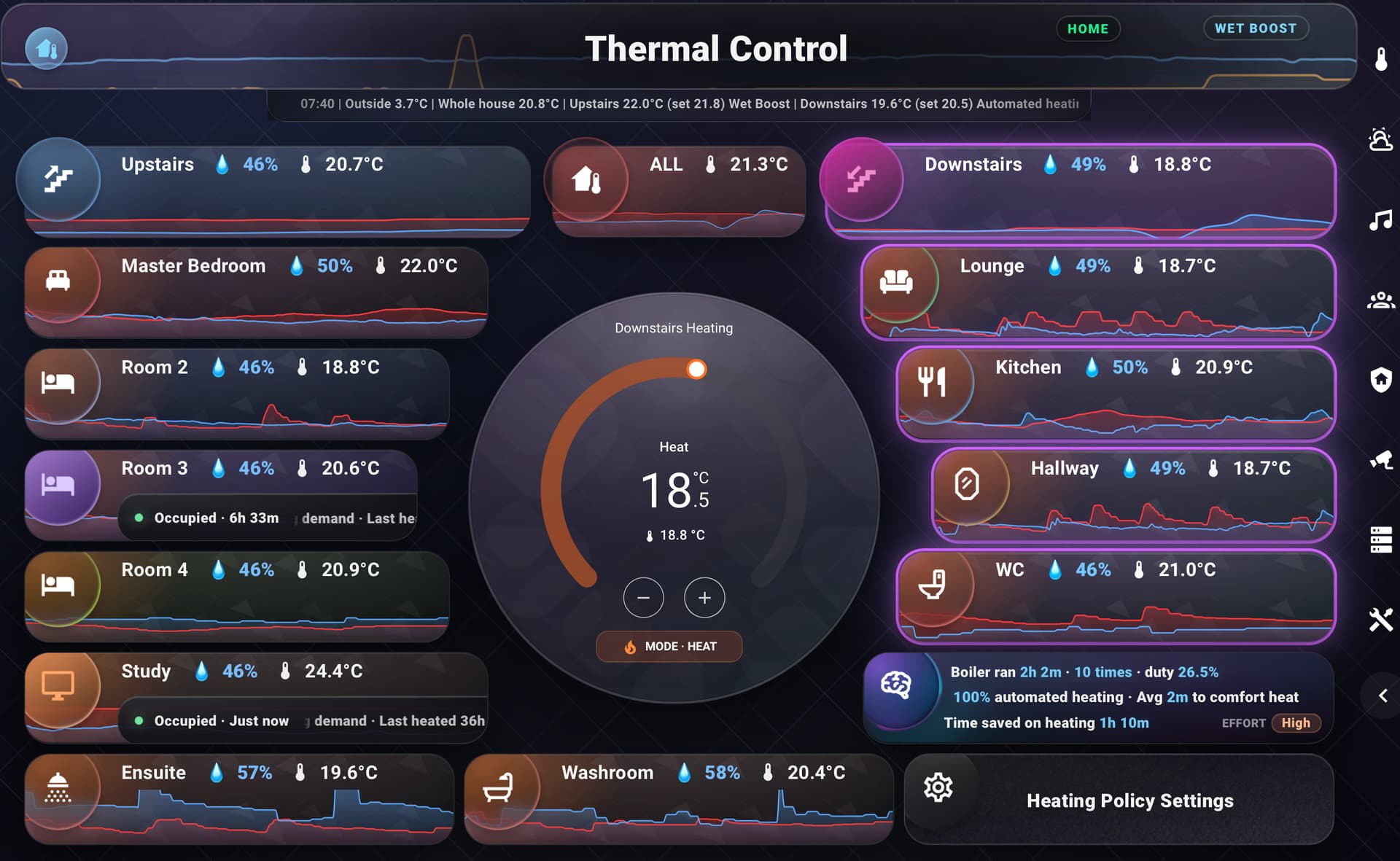

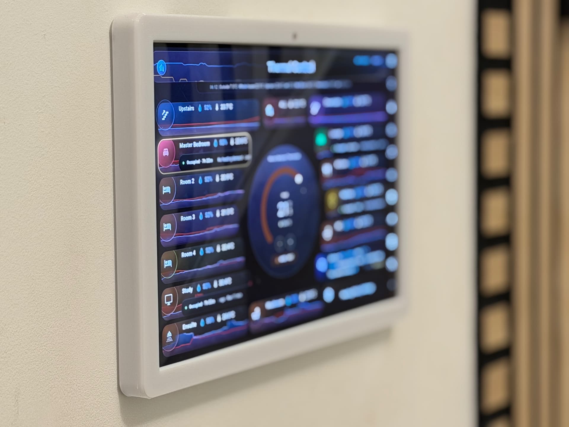

The “Beauty” (The Dashboard)
I’ve extended the glassmorphic aesthetic of my main dashboard into a specialized Thermal Control view.
  • Adaptive Central Dial: Changes context based on the selected room.
  • Live Snapshots: Real-time temperature/humidity traces across the house.
  • Efficiency Insights: Local AI-generated insights based on boiler runtime and history.
  • Heating Policy Settings: Rather than having to change the figures within scripts/automations, an inbuilt section to the dashboard that controls all figures pertinent to the Heating Policy.
