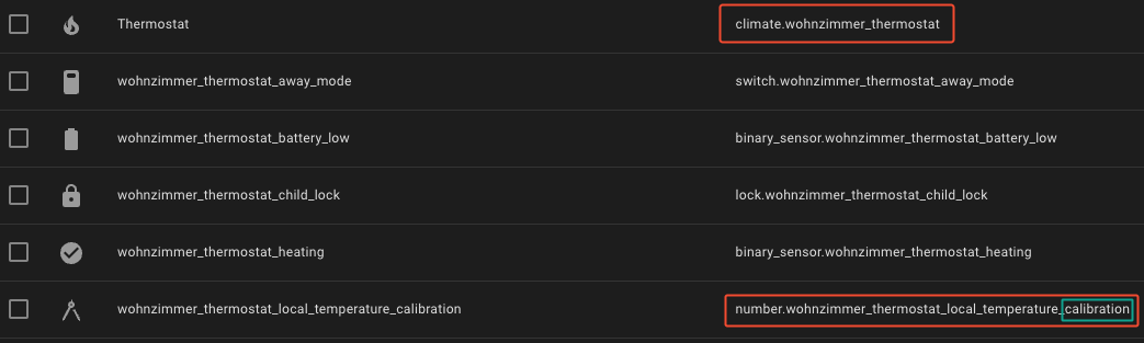

It depends on your trv. If it supports calibration e.g. z2m provides an calibration entity. In its id calibration is set per default.
If its the case you can simply provide an external temperature sensor.
UPDATE: You can now add an external sensor. If your TRVs supports calibration and there is a calibration entity with calibration or offset in its id you are free to add an external sensor. Now the TRVs get calibrated every 10 minutes. It doesn’t matter which zigbee integration you prefer.
