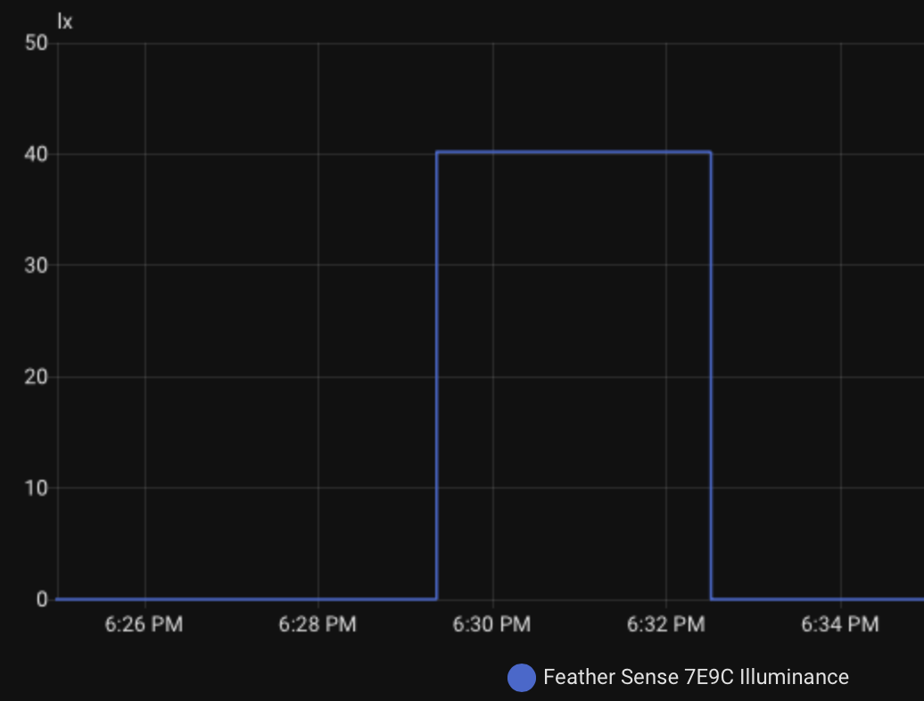

I’m trying to build a BLE sensor beacon to detect how often my Rivian’s headlights turn themselves on unexpectedly in the middle of the night. I programmed an Adafruit Feather Sense, transmitting data to Home Assistant using the BTHome integration. To start with, I set it to advertise for 1 second, then sleep for 1 second. It works, but it doesn’t capture brief changes properly. For example, if the headlights turn on for 30 seconds, the HA history shows it was on for 3 minutes.
I’m wondering if maybe HA is missing some of the broadcasts. Maybe I need to increase the advertising time, or decrease the interval between advertisements. Not sure what is common for other beacons like this. If it does miss a broadcast, is there some mechanism whereby HA would keep the last value for awhile before switching to “no data”?

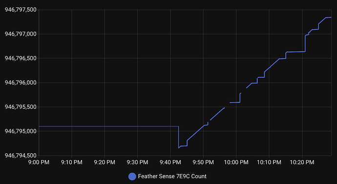

I added a counter sensor which just increments a number every second, so I’ve learned that the HA history view can show resolution with single second precision.
Sometimes the history view shows a flat line instead of a gap, which makes me think HA is holding on to stale values when it shouldn’t.

Putting the light detection logic on the board is a good idea, that might do a better job catching quick changes. I’m doing that now (using CircuitPython), but HA still shows the same problem, where the monotonic counter is sometimes flatlining.
Is there a way to make HA log the raw bytes of every BLE packet received? I couldn’t find that in the debug loggers.

I’m receiving the packets on my Home Assistant server, a Raspberry Pi 4. It’s connected via Ethernet so I don’t think Wifi should interfere. Just to make sure, today I disabled Wifi at the hardware level using the config.txt overlay and that didn’t change the results.
Looking closer at the history graph, I realized it does show the exact timestamps for each data point when you hover the mouse on the line, so I can confirm these flat lines represent missing samples. After a while, the line disappears and the entity becomes unavailable, but I’m not sure exactly how long that takes.
I’ve tried various different advertising intervals (i.e. 1000ms on, 4000ms off) and in each case, Home Assistant occasionally misses some samples. I’m not sure if this is a limitation of the BT hardware, or something in Home Assistant software. I suppose HA is not really designed for high frequency data like this, so it would make sense to skip samples if the CPU is busy doing other tasks.
