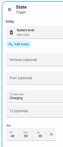

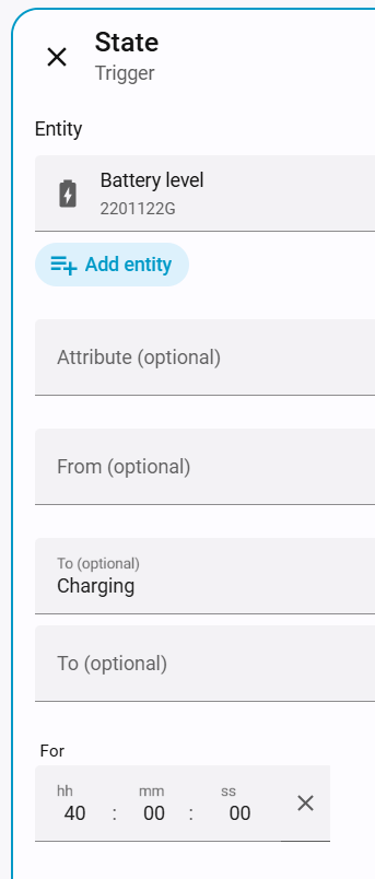

Ahhhh, after reading carefully the blog above i now understand how it works. the state is set to Idle (it can be anything), and the trigger uses for after a “change” (“the status is changed and stays the same for …”).
For instance
would mean “trigger if the battery status is ‘Charging’ for 50 hours or more”
If this works it would be the perfect solution!
