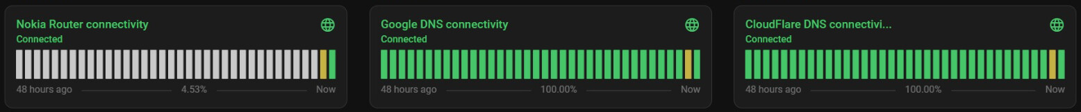

Here is my updated dashboard for this.
Hey @Blue407 what type of control are you using for the top sections please?
Im trying to replicate this dashboard
The closest I could get is with a History graph Card but it doesn’t seem to let me change the bottom row or add an icon on the right
Hi. These are setup as Uptime cards. Hope this helps.

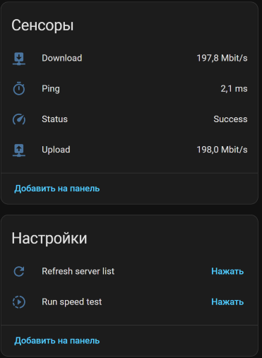

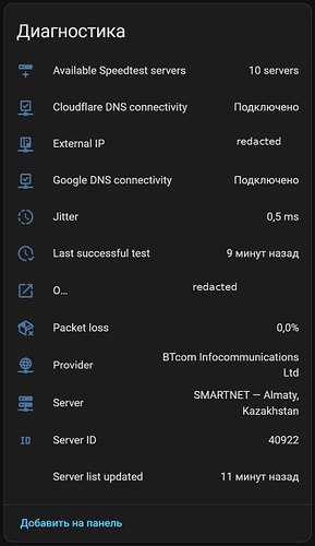

I recently published a Home Assistant App that covers this use case without requiring a separate Docker host, external scripts, or a Home Assistant automation for scheduling:
DigitalHouses Speedtest
It runs the official Ookla Speedtest CLI directly as a Home Assistant App and creates a single MQTT device in Home Assistant.
Main features:
  • scheduled speed tests with a configurable interval;
  • manual speed-test button;
  • download, upload, ping, jitter and packet-loss sensors;
  • independent connectivity checks against 8.8.8.8 and 1.1.1.1;
  • the speed test is skipped when both connectivity targets are unavailable;
  • preferred Ookla server IDs with automatic fallback;
  • nearby-server discovery from Home Assistant;
  • ISP, external IP, selected server, server ID and Ookla result URL;
  • MQTT Discovery, so the device and entities appear automatically;
  • optional Recorder package for history and analysis.
It is currently an initial public release, version 1.0.0, tested on Home Assistant OS with amd64 architecture. MQTT is required.
