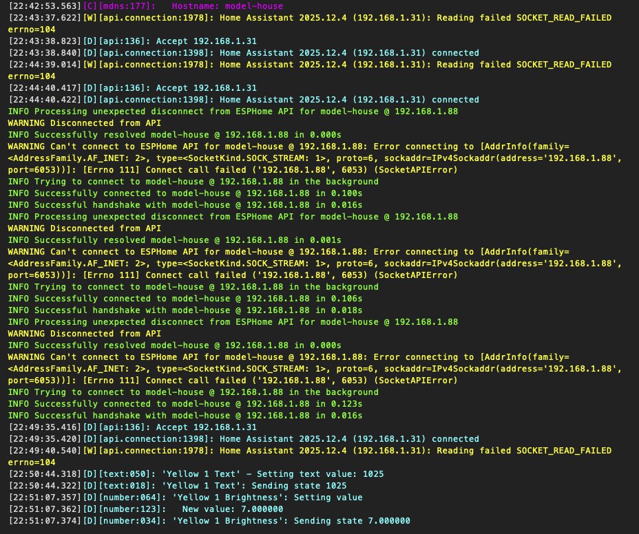

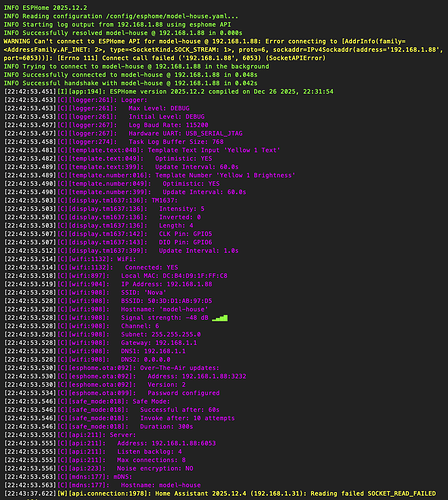

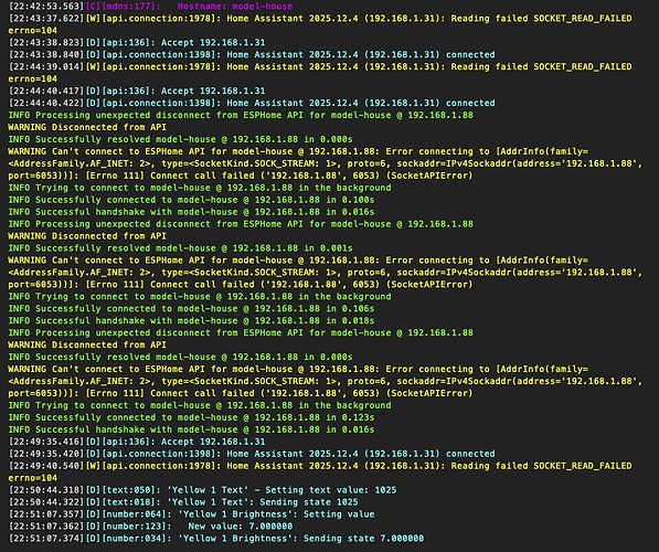

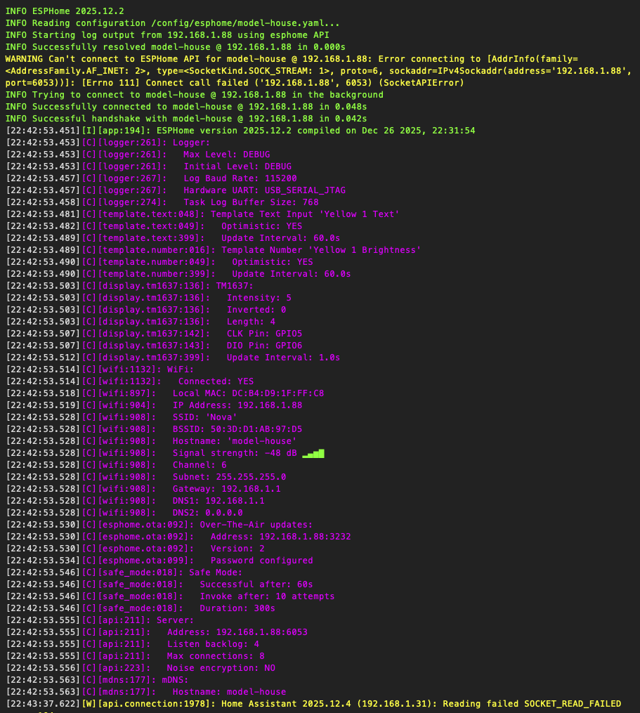

Sorry, please find a log file embedded below – I attached screenshots as I assumed it would be easier to read them if they were already coloured:

Is there any indication from this why it might be losing the connection? It seems to have a decent signal strength?
Many thanks for your help!
David
