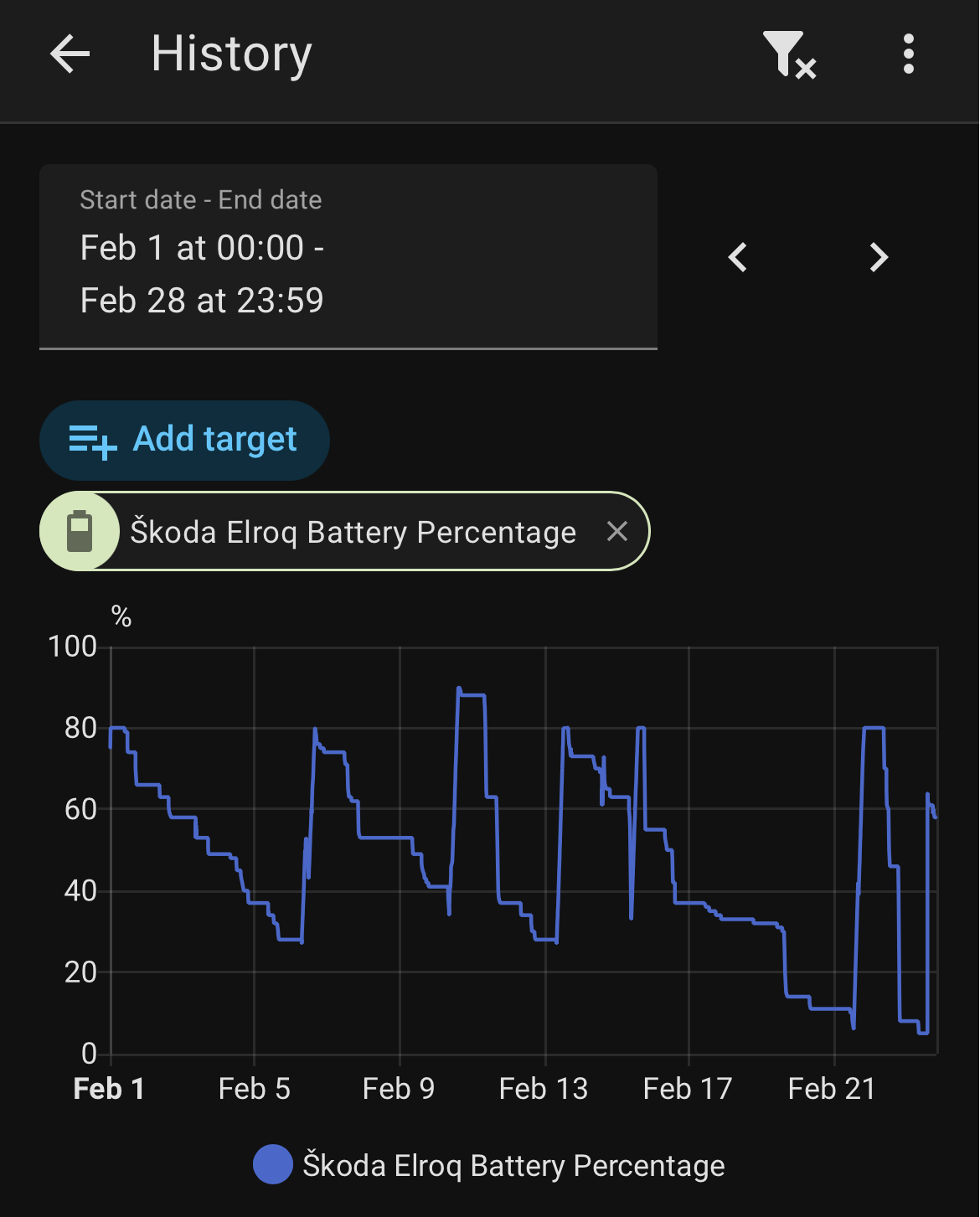

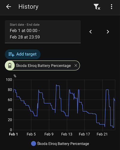

The history of my car is already available in mySkoda integration:

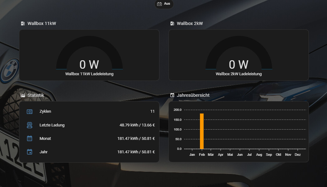

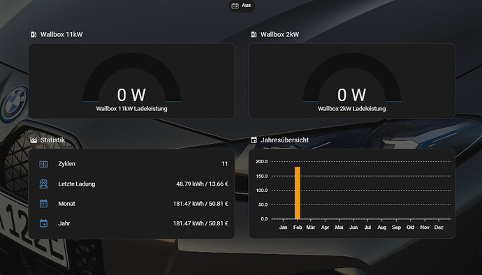

I had a similar idea this month and wanted to track my EV charging sessions. Unfortunately, BMW doesn’t currently allow integration with Home Assistant. So, I’ve only integrated the monitoring of my wallboxes into Home Assistant. I’m using Shelly power meters.
