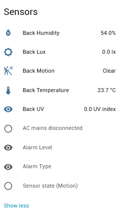

I have installed two old MS6s and two new MS7s. The Multisensor 6s work fine. But the Multisensor 7s don’t detect motion. They show lux, humidity and temperature. But they always show clear for motion.
I tried comparing the configuration, but it has changed a bit.
Enable the disabled sensors in the integration for the device one of them should work
The motion sensor is already enabled and visible
What are the disabled sensors?
These are all of them.
I have enabled Sensor State motion now, and it always says ON
