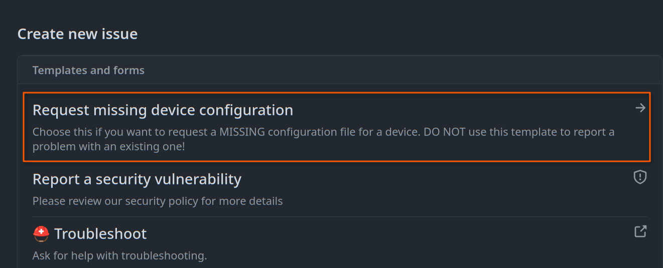

Feature requests are only done on GitHub. You would have to make an account.
You are addressing tens of thousands of people in this post, but all community members so I have no idea how to do this, and neither do most of us.
Feature request link here:
You will need to create a GitHub account and make a request for a new device config or submit the file yourself to the Z-Wave JS project. Or wait and hope someone else gets to it eventually.
https://github.com/zwave-js/zwave-js/issues/new/choose
or just https://github.com/zwave-js/zwave-js/issues/new?template=device_config.yml directly.
If you want to submit the change yourself, follow https://zwave-js.github.io/zwave-js/#/config-files/contributing-files. Also requires a GitHub account.
