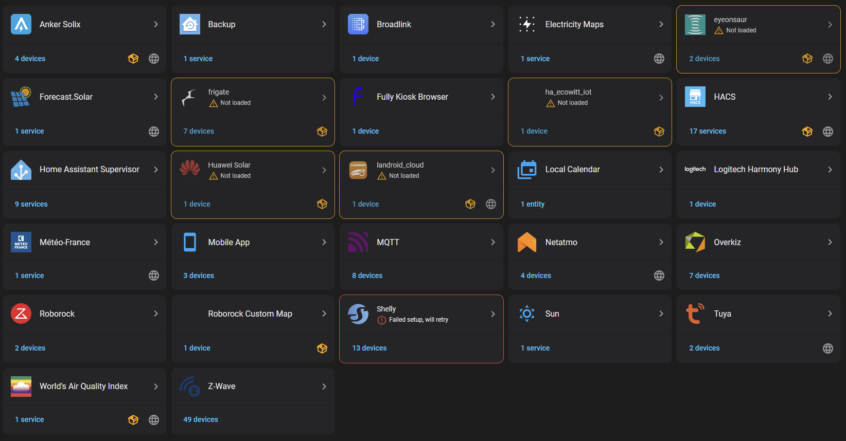

Since the last update (2025.10.4), 5x integrations aren’t working :frowning:
First time in years that I’m disappointed of Home Assistant.
It is all the same problem: DNS issue with python metadata file.
What can be done about it?
