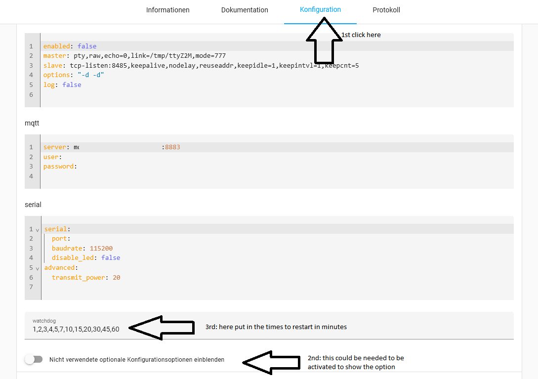

And what firmware versions ?
All up to date…in that ive been carrying out the firmware updates according to the HA letting me know theres a new version out…
That points to a network disconnection, but if everything is up to date. Have you enabled the watchdog in the add-on ?
Yes - watchdog is running, i can also log into the SLB and see that its live and connected to the internet. Im at work at the moment but i can login to home and reboot the poe network switch which will force a reboot of the SLB’s…
This one too ?
let me check…
Edit - no watchdog is not running there…can i transpose your settings there to it?
Yes you can
ok - thats done (thanks very much) thats a new setting i didnt know of.
Edit - error is still there, but now the setting is in its rolling round each time…but thats still a handy setting though! :slight_smile:
