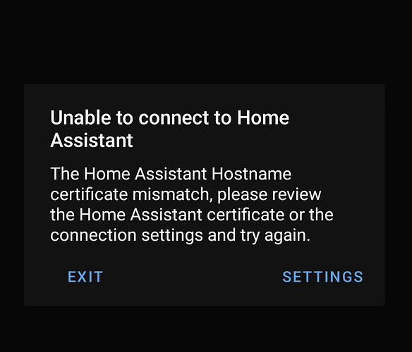

After turning on HTTPS, Android app can't connect when on LAN
I used the duckdns w/ letsencrypt addon to enable HTTPS on my HA instance. I can now connect to my HA from the internet via HTTPS. However, local access on the LAN is not working on Android app. I’d like the Android app to work even when I’m on my home wifi.
I’m able to access the HA via a computer on the same LAN, and via web browser on my phone, via the https://192.168 address.

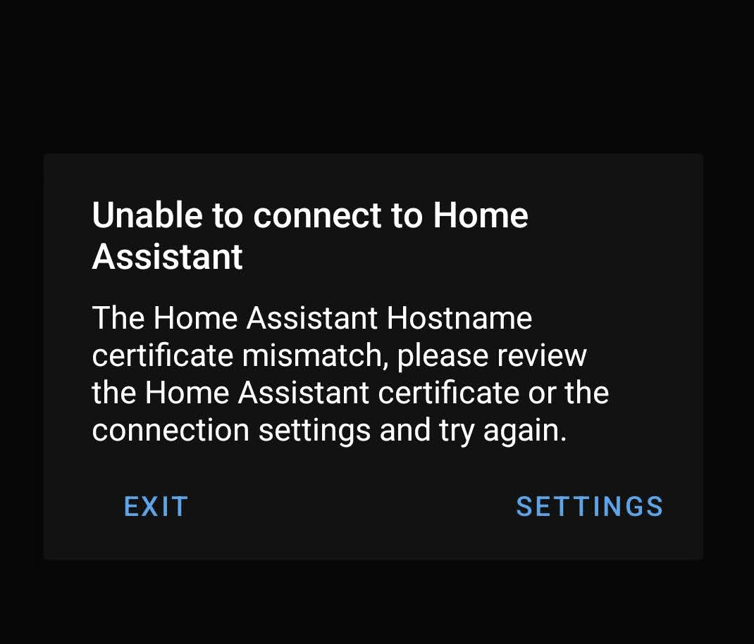

But when I’m on local LAN, the app throws these errors. It seem like when it’s on the correct wifi (the ssid that is listed as local), it fails to recognize that its on LAN wifi and tries to use the remote connection maybe? I’ve made sure the HA app has location and nearby devices permissions.
Home Assistant URL: https://MySubDomain.duckdns.org
Home network: added my wifi name from the pick, so no mistakes.
Internal Connection URL: https://192.168.1.104:8123/
I’ve updated the Android app to the latest today, and I’m on 2025.12.1 of HA. A bit ago, when I first started setting this up, it seemed like I got it working on LAN. But now none of the 3 Android phones’s HA app are capable to accessing HA in WiFi.

Thats expected cause the certificate its issued for a domain that doesnt match with your local network domain.

I think you misunderstood. For local connection with both your phone and your HA in the same LAN, you will want to use http://192.168.1.104:8123/ in the Internal connection URL field. I hope that still works.
… because if using https on 192.168.x.x, you would not survive the certificate challenge, as such (unlike a browser) the app would not know what to do, and then you see the “mismatch” error message.
One way to get around this is to also use https://MySubDomain.duckdns.org in the Internal connection URL field. But then there is a small(?) downside: when your internet is down, DNS challenge would fail, you would not be able to get to your HA even when your phone and HA server are both inside the same LAN.
If you really want to do local IP with https, you will want to set up / manage your own SSL certificate, and this is in addition to DuckDNS & LetsEncrypt, which covers remote access but not local https. This is definitely possible but not very user friendly / not straightforward.
If you want to go this route, look into Nginx Proxy add-on, which handles LetsEncrypt also. I’m sure there are YouTube out there about this very subject.
