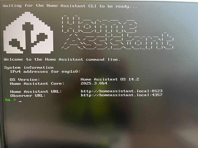

that is my screen
without connected netweork cable
Looks like you’re on the beta channel (Home Assistant Core 2025.3.0b4).
Might be an issue with the beta branch you’re on (judging by the ob4 in your version). Can you connect an ethernet cable and move to the release branch? use ha core update --version 2025.3.0
You need to restart HA with a connected ethernet cable, otherwise the observer will always say ‘Disconnected’
Thank you. How can I downgrade to an old Version?
Thank you, after a few attempts it works again I Hope at the moment
