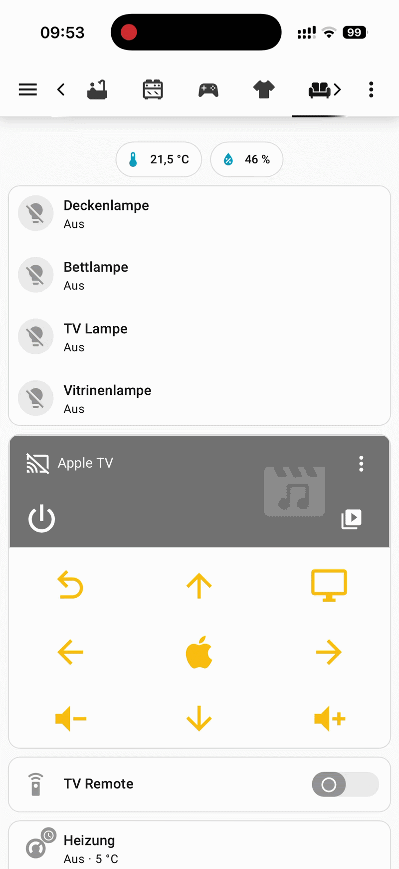

After Update to 2026.4 UI Slow
See
IMG_6849
With 2026.4.1 the same, before all was fine.

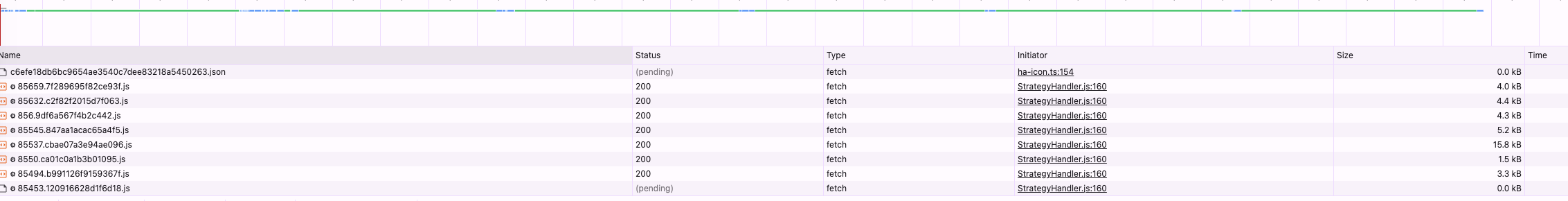

I noticed there, and on subsequent dashboard that a large number of .js files are all loading sequentially and very slowly. See network timeline.
What’s very interesting is that if I hit the UI directly, instead of nginx proxy, it loads very fast (less than a second)
Screenshot 2026-05-01 at 5.31.51 AM
But I did not update or change nginx, this started with the 2026.4 upgrade.
