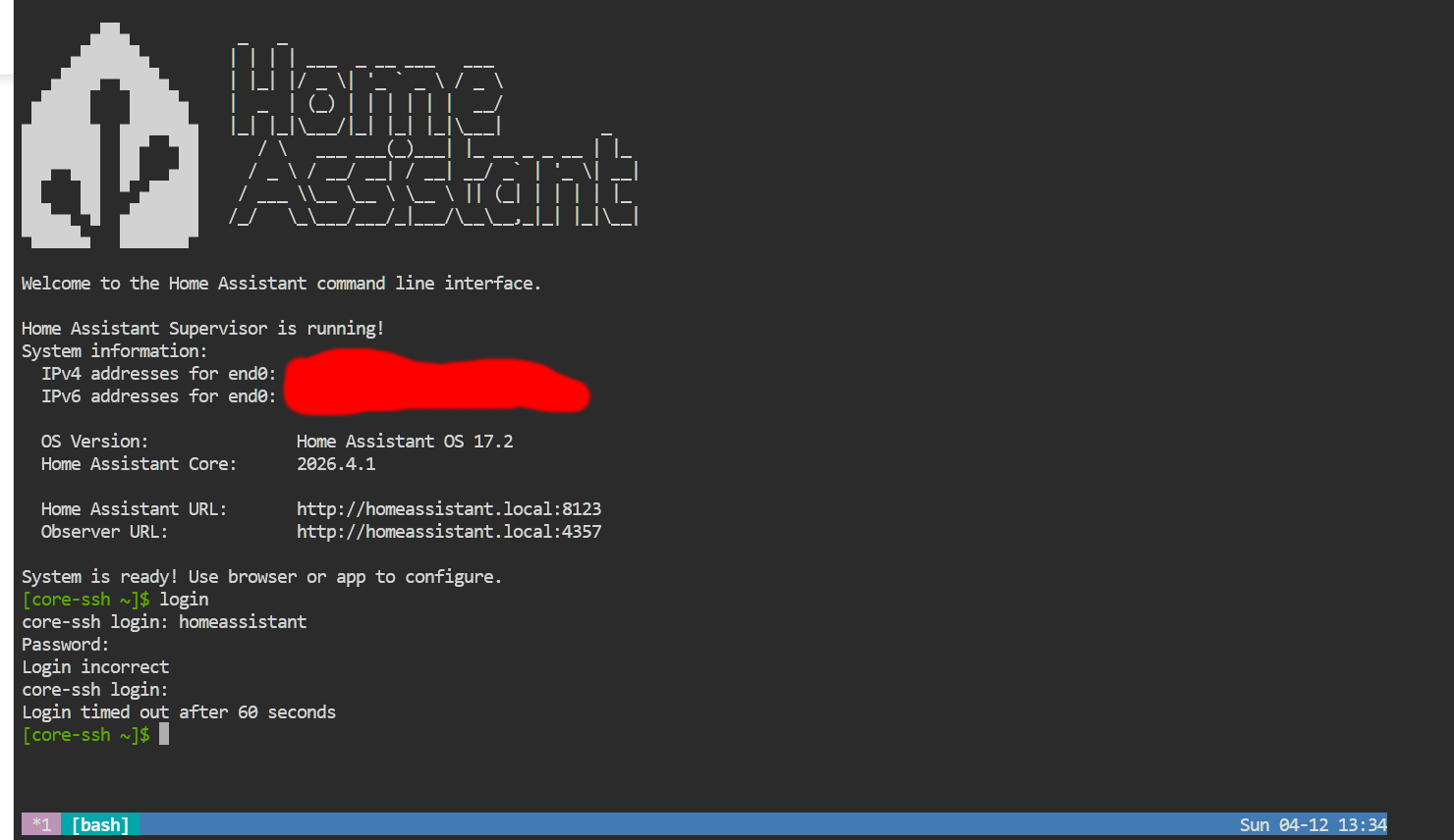

After updating to 2026.4.2, Dconz and rtl_433 do not work
Hi, the whole Home Assistant thing for me is that I use various devices communicating via Dconz and rtl_433.
After the last update, not a single application works.
rtl_433 does not start and if I start it manually it stops.

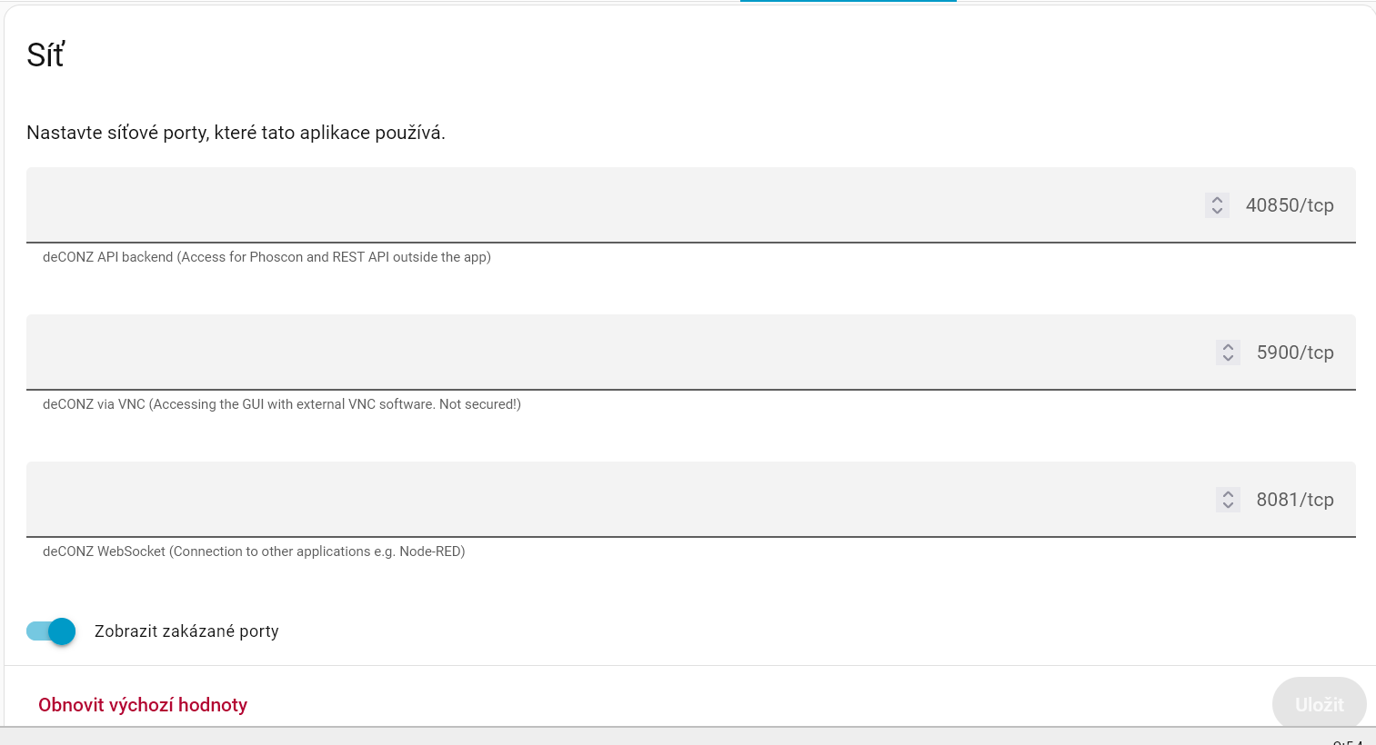

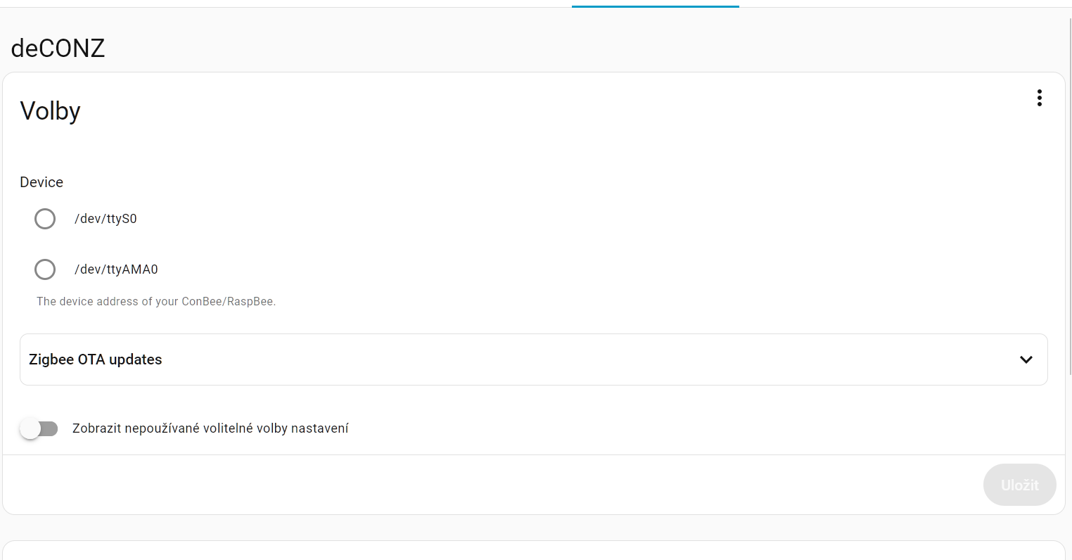

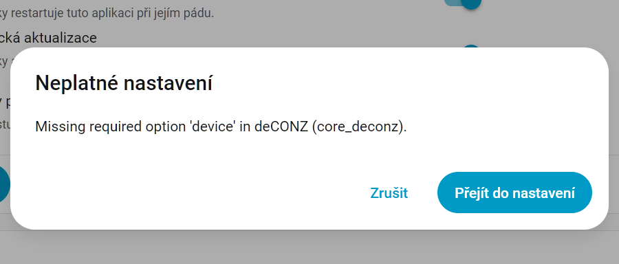

Deconz does not start and when I try to start it writes an error that can be seen in the picture below.
I am attaching logs from both applications and a screen of the deconz settings.

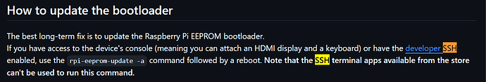

Did you also update the OS to 17.2 by any chance? Also, are you running HA on a Raspberry Pi4?
If the answer to both the above questions is yes, you need to update the eeprom on the Pi. Read this for step by step instructions.
Thank you for the answer. It is exactly as you say. I have OS 17.2 and RPi4.
I also performed a backup of 4 days ago but it did not help. Somewhere on the internet they wrote that in the configuration file you need to re-enable UART so I did that and it did not help either.
Now I would like to update the epprom but I can’t log in in the command line.
I also use Samba share. So I tried to enter the login details that Samba uses but it does not work. How should I do it please?

The first post on that issue explains that you cannot use the SSH addon to login
You need to hook up a keyboard & monitor to your Pi, or else use Raspberry Pi Imager and a spare SD card as mentioned in the Github issue.
