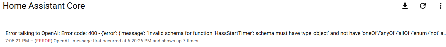

Look in the core log. It will list an error code.
Probably error 400 something… What is it?
Does it look like the one here?
Yes, similar message. I just generated this error when I said “Hey Jarvis” what time is it?
Yes it’s the same error. Can you open a bug on it for core? Post that log entry in the bug and what you were doing. I’ll add mine to it.

No it’s an error with an intent. They made some changes to how time was handled last version and they were they were optimizing it further and I suspect something got busted.
The error points at which intent has the issue
