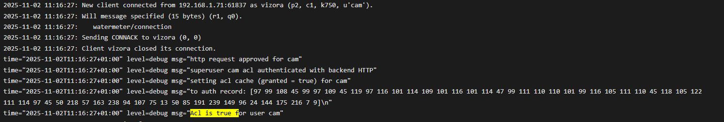

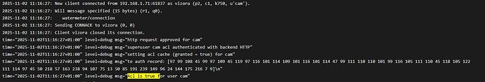

I can’t see any error in the Mosquito log, after a succesful connect and a CONNACK message the client just closes the connection.

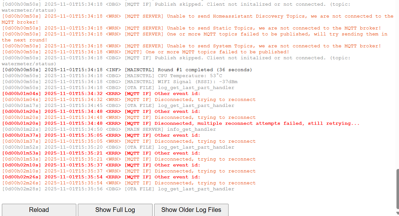

On the client side there is an error ’ [MQTT IF] Other event id:’ but no explanation.

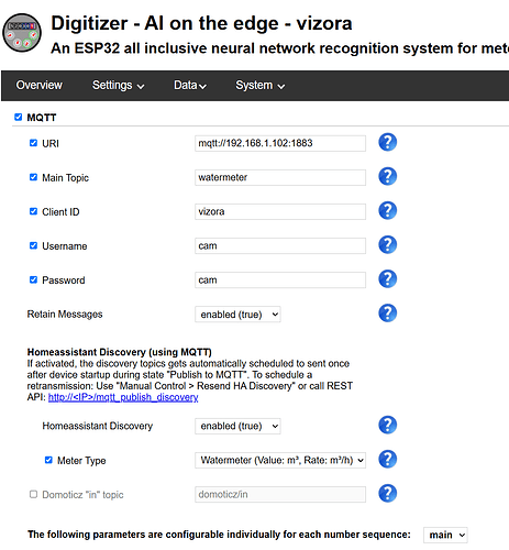

  • changing user
  • changing client Id
  • changing main topic

  • Homeassistant Discovery ON/OFF
Attached the Mosquito log, AI-On-The-Edge log, AI-On-The-Edge config
