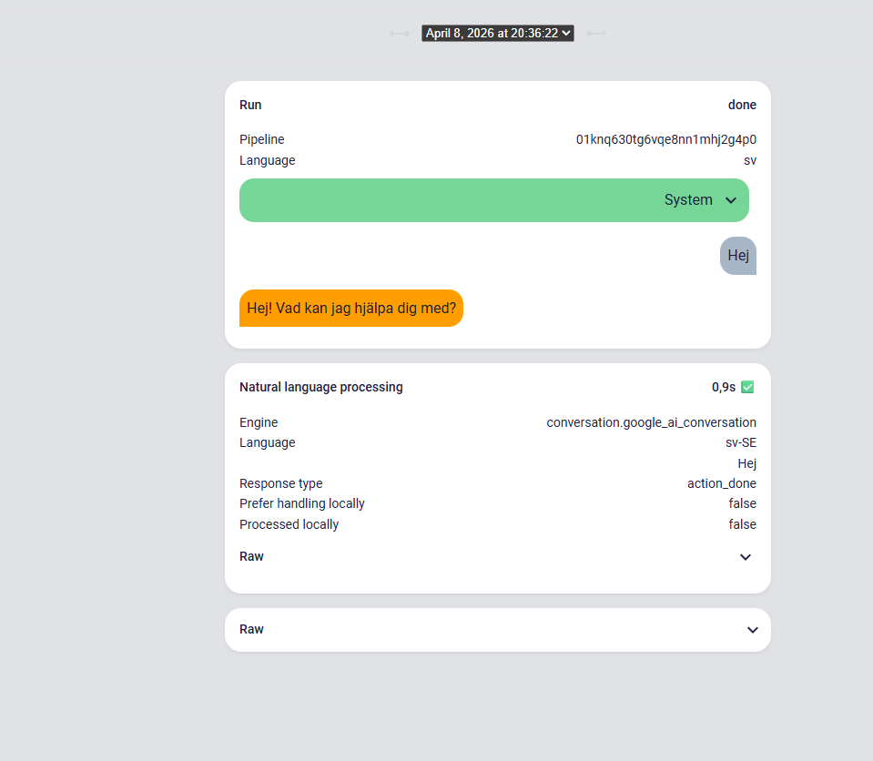

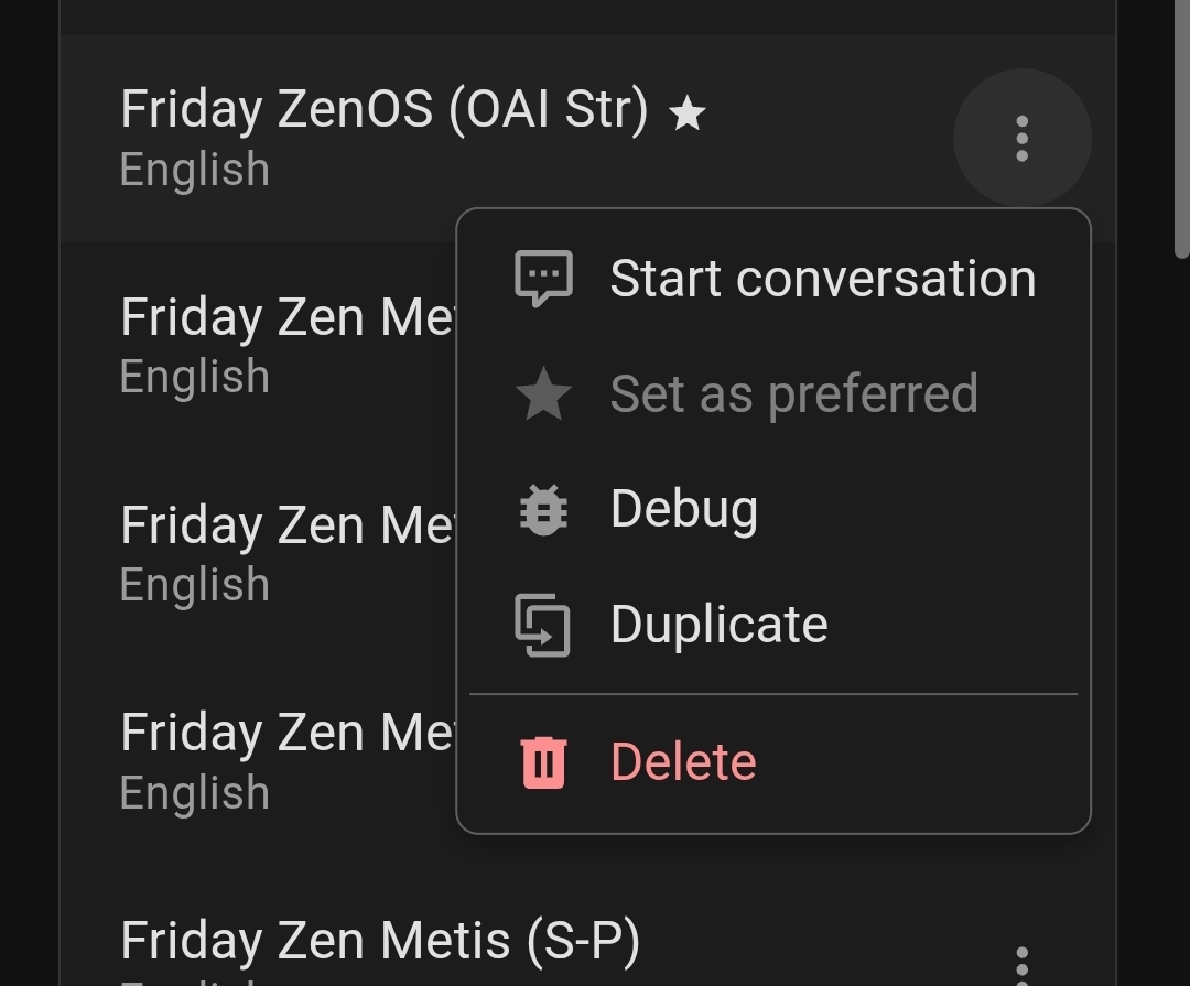

Look in your voice debug logs, see if the agent is even attempting to call it.
Go to settings, Voice and pick your agent then select Debug.
I can start a conversation and get this information in debug.

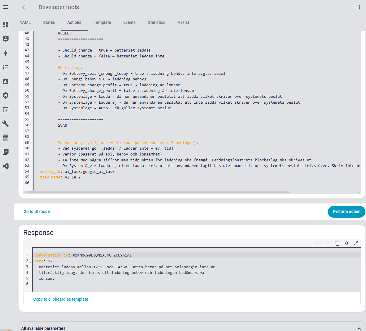

The strange thing is that I can run the action in the Dev Tools and get generated data, but it doesn’t work in my template sensor.
