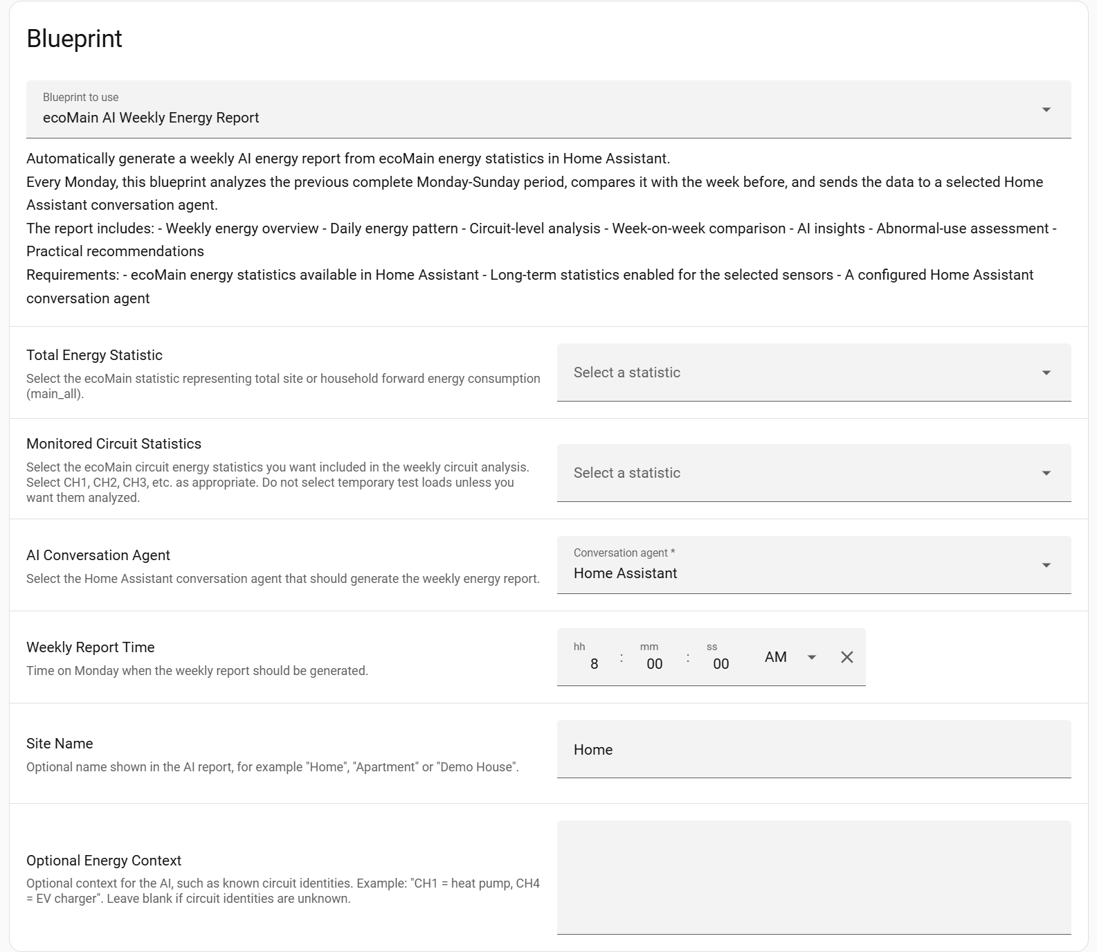

3. Configure the Blueprint
You mainly need to configure:
Setting What to select
Total Energy Statistic Your whole-home or site-level cumulative energy statistic
Monitored Circuit Statistics The circuits or sub-meters you want included in the weekly comparison
AI Conversation Agent The Home Assistant Conversation Agent that will write the report
Weekly Report Time The time on Monday when the report should run
Site Name Optional name displayed in the report
Optional Energy Context Optional descriptions for known circuits
[!IMPORTANT]
Do not copy the entity or statistic IDs from my setup. Select the statistics from your own Home Assistant installation.

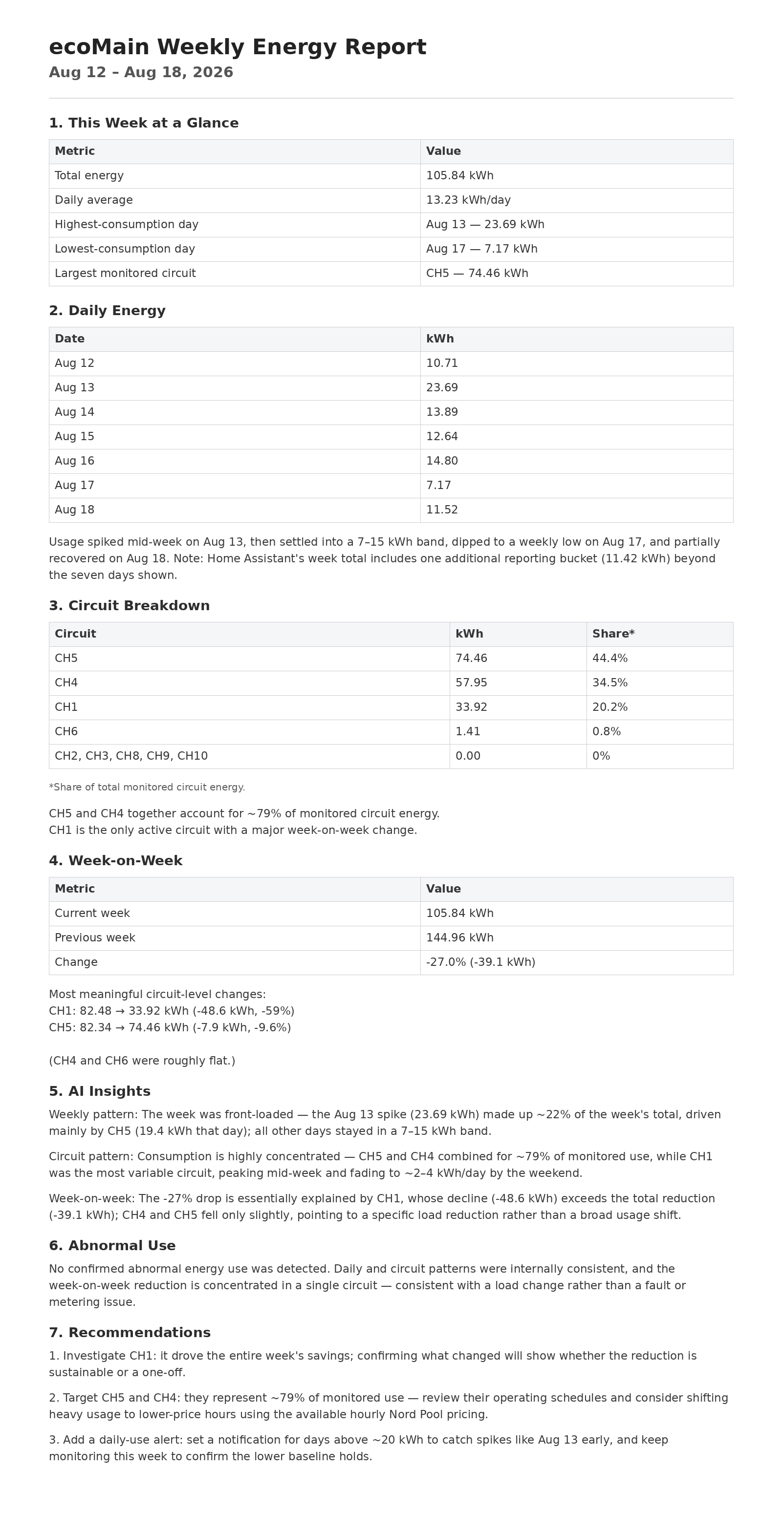

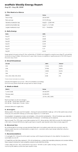

:page_facing_up: Example Report Structure
The generated report contains:
  1. This Week at a Glance
  2. Daily Energy
  3. Circuit Breakdown
  4. Week-on-Week Comparison
  5. AI Insights
  6. Abnormal Use Assessment
  7. Recommendations
The exact wording depends on the selected statistics, optional context, and Conversation Agent.
Example AI-Generated Report
After Home Assistant calculates the weekly statistics, the selected Conversation Agent turns the structured data into the final report shown in a persistent notification.
Example report generated in my test environment. Your values, circuit names, and wording will depend on your own setup.

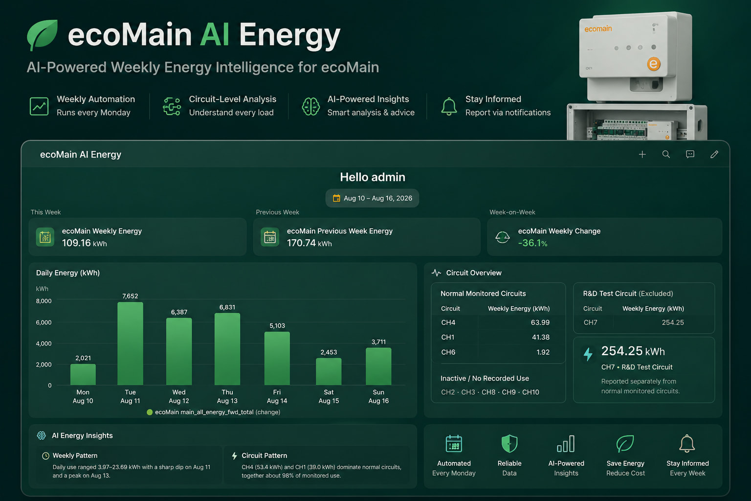

:chart_increasing: Optional Dashboard
The Blueprint’s core output is the weekly report shown as a Home Assistant persistent notification.
A dashboard is optional.
During testing, I also used a dashboard to display:
  • latest-week energy
  • previous-week energy
  • week-on-week change
  • daily energy chart
  • circuit overview
  • short AI insights
The Blueprint does not include or require a specific dashboard layout, so you can build one using the cards and design you prefer.
