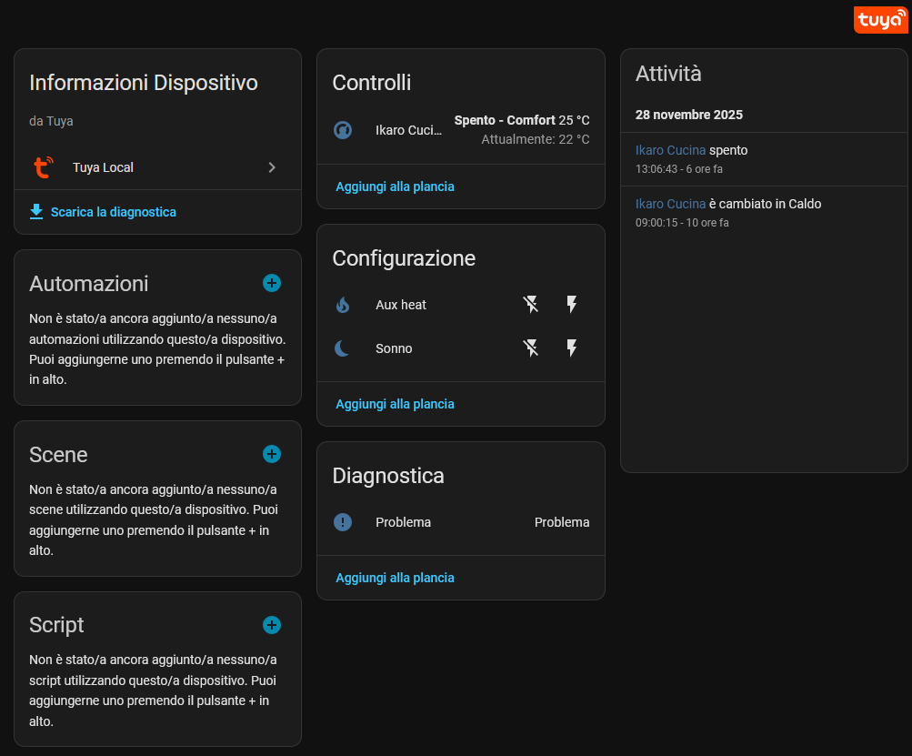

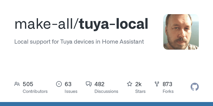

Ciao pierfrancesco, i have 6x IdealClima Ikaro, this is my conffiguration with Tuya Local
