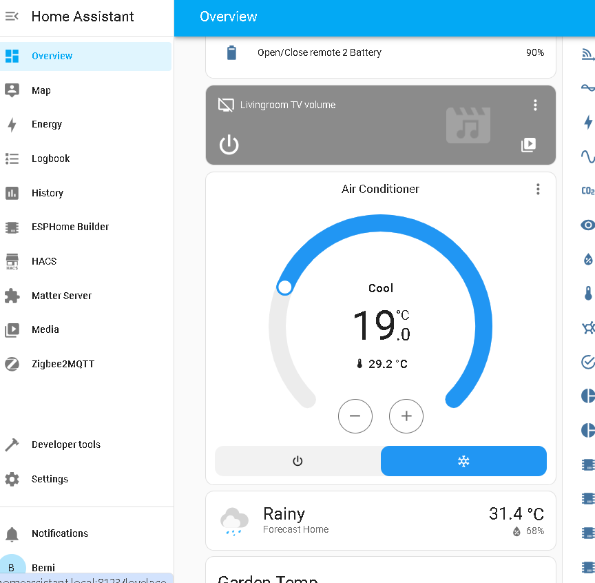

Does anyone know of any IR Blaster that can be set in HomaAssistant to show control similar to the Aqara M3 hub integration I want to get away from using the Aqara hub as it requires internet, I have only seen IR blasters where you have to teach it each and every command and at the end you just get a lot of buttons to do each thing
See above image of my screen. this is able to control by voice or touch screen on tablet or phone.
I bought the Broadlnk but this needs to learn each button. Aqara just needs to know the Airconditioner model and make

I want to be able to do this as the M3 hub Air Conditioner entity shows nicely in Home Assistant as a device (see above topic) that it can control, if I use the M2 hub and add the air conditioner it is not visible in Home Assistant.
