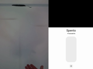

I built a touchless light dimmer using an ESP32 and a VL53L1X time-of-flight sensor.
Move your hand up and down in front of the sensor and the light brightness changes instantly.
Demo
