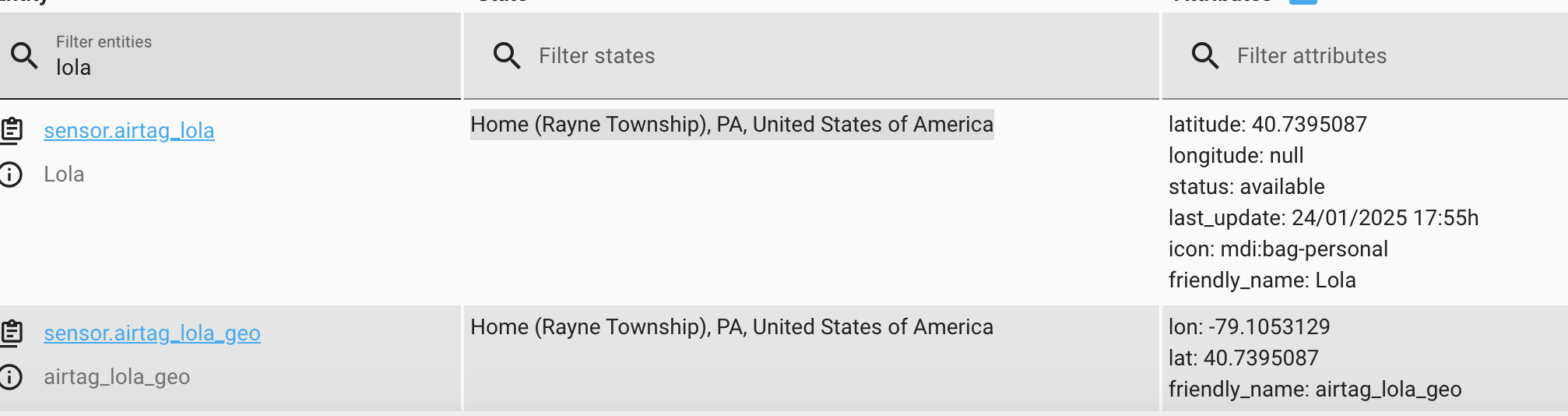

Restarted HA and then Reloaded the configs… Now getting something very strange…
That is not my input address (or anywhere close)… Also look at the null for Long still in the top sensor… Also is there a reason there are 2 sensors showing?
I would double check your configuration, I think you probably made a typo in there.

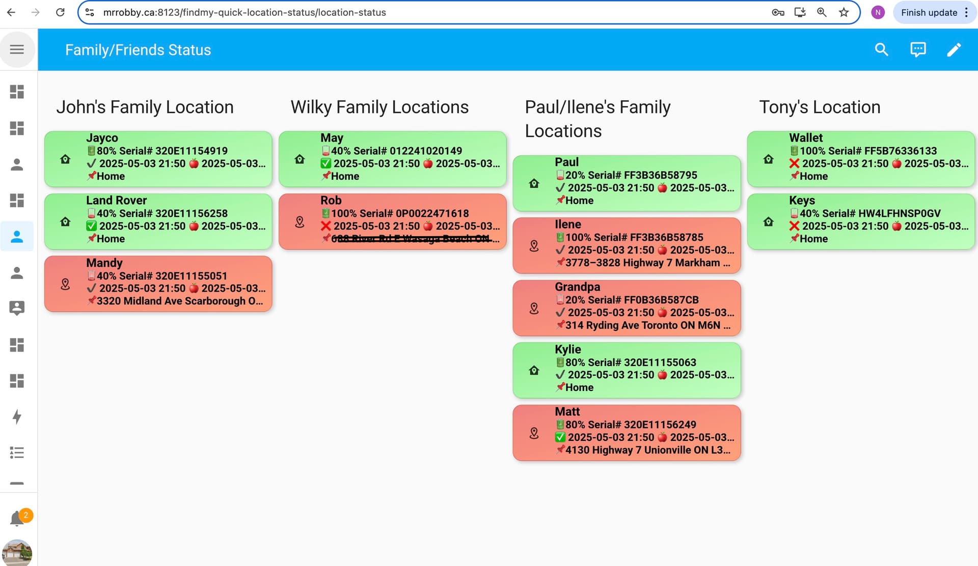

Built my first Dashboard in Home Assistant showing Airtags (FindMy tags mostly).
Amazing! Thanks for sharing!

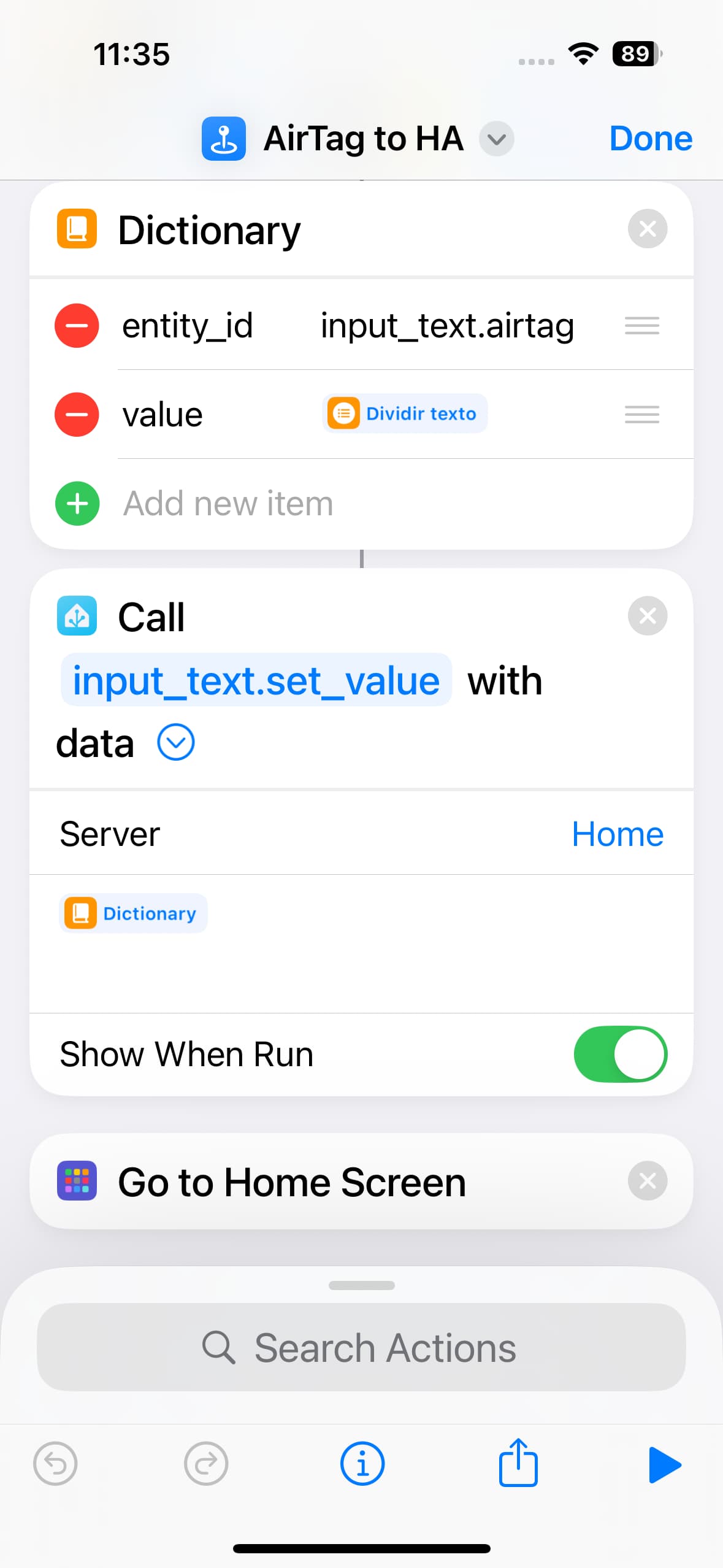

Hi TiToTB - thank you so much for your hard work! I have tried to follow your (English) instructions, but I don’t quite understand what you mean by …
3. Look for the «Call» action with the Home Assistant icon and tap on the arrow icon to expand the details. In the «Server» section, **you must select your Home Assistant instance** to send the data.
I use Nabu Casa, so do I just tap on the word & select “Home”, or “Select a Variable” or maybe something else? At the moment, after putting the text in my sensor.yaml file, I only get “unavailable”.
Many thanks!
Thanks hottl!
That point refers to the Shortcuts app on the iPhone.
By the way, since there have been many questions about this integration, I created a dedicated thread in our English community (in case you need help or want to share ideas).
Yes, I am within the Shortcuts app, but am not sure what I should put next to “Server”? At the moment I have selected “Home” (see below), but am not sure if this is correct.
Yes, if that’s the name of your Home Assistant instance
