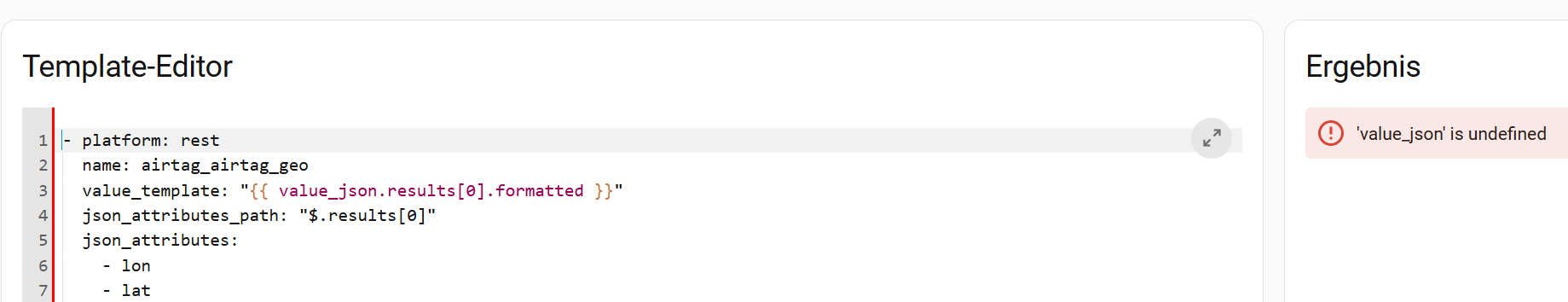

The only issue left is with the rest sensor, i get an undefined error for value_json … so its not parsing the “input_text.airtag” i assume leaving GPS coordinated empty in the sensor. Any ideas?
edit: after a long day the following addition to the code fixed the issue i had. this is especially for german user, when the location is shown as “Privat”

I tried with and without the strip() from @PX80 but still can’t find why it doesn’t work.
you will have to restart the REST Service in the Developer Menu … took me a day to figure out -.- … so once the REST Service was restarted you will see the geo sensor
Oh waaah! Magical! Thanks @PX80, I never had guessed that by myself. Maybe a good thing to add it to the Aguacatec tutorial @TiToTB ?

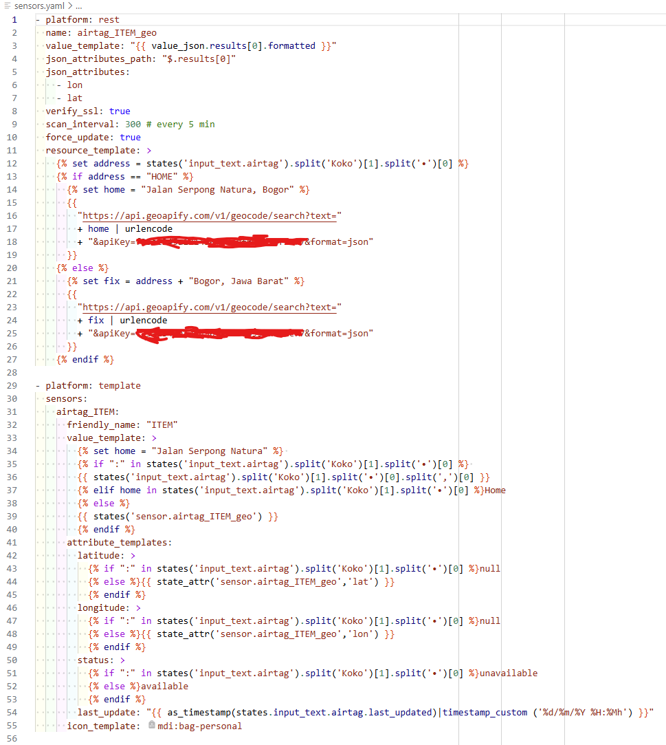

Helper already get information from airtag, but I still cant find sensor.airtag
Here my sensors.yaml config
And I already call sensors.yaml in configuration
