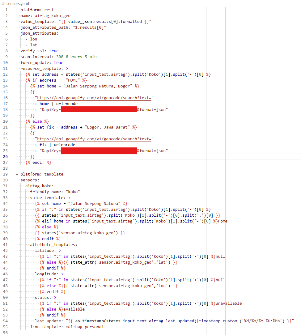

AirTag "integration" (user friendly + device tracker)
Hi there!
Sensor names cannot contain uppercase letters, spaces, or special accents :slight_smile:
Thanks for your fast respon
I already update sensor name without uppercase, space, or special accents but still find sensor

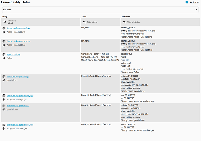

Thanks for your hard work on this. I’m trying to use this to send us alerts when my Dad, who has dementia, leaves the home location. I’ve almost got it working, but it appears to constantly lock the location to my country without any address. Any ideas? Everything looks good with the text import as far as I can tell, but it looks like it’s failing to pick up the “Home” and therefore assigning just the Country which I have set in the next section.
Here’s my code…
- platform: rest
  value_template: "{{ value_json.results[0].formatted }}"
  json_attributes_path: "$.results[0]"
  json_attributes:
    - lon
    - lat
  verify_ssl: true
  scan_interval: 300 # every 5 min
  force_update: true
  resource_template: >
    {% set address = states('input_text.airtag').split('GrandadKeys')[1].split('•')[0] %}
    {% if address == "Home" %}
      {% set home = "14 Craigallan Park, Bo'ness" %}
        "https://api.geoapify.com/v1/geocode/search?text="
        + home | urlencode
        + "&apiKey=*****&format=json"
    {% else %}
      {% set fix = address + "Scotland, UK" %}
        + fix | urlencode
        + "&apiKey=******&format=json"
    {% endif %}
- platform: template
  sensors:
    airtag_grandadkeys:
      friendly_name: "grandadkeys"
      value_template: >
        {% if ":" in states('input_text.airtag').split('GrandadKeys')[1].split('•')[0] %}
        {{ states('input_text.airtag').split('GrandadKeys')[1].split('•')[0].split(',')[0] }}
        {% elif home in states('input_text.airtag').split('GrandadKeys')[1].split('•')[0] %}Home
        {% else %}
        {{ states('sensor.airtag_grandadkeys_geo') }}
        {% endif %}
      attribute_templates:
        latitude: >
          {% if ":" in states('input_text.airtag').split('GrandadKeys')[1].split('•')[0] %}null
          {% else %}{{ state_attr('sensor.airtag_grandadkeys_geo','lat') }}
          {% endif %}
        longitude: >
          {% else %}{{ state_attr('sensor.airtag_grandadkeys_geo','lon') }}
          {% endif %}
        status: >
          {% if ":" in states('input_text.airtag').split('GrandadKeys')[1].split('•')[0] %}unavailable
          {% else %}available
          {% endif %}
        last_update: "{{ as_timestamp(states.input_text.airtag.last_updated)|timestamp_custom ('%d/%m/%Y %H:%Mh') }}"
      icon_template: mdi:bag-personal
- platform: rest
  json_attributes:
    - lon
    - lat
  verify_ssl: true
  force_update: true
    {% set address = states('input_text.airtag').split('GrandadShoe')[1].split('•')[0] %}
      {% set home = "14 Craigallan Park, Bo'ness, EH51 9QY" %}
        + home | urlencode
    {% else %}
      {% set fix = address + "Scotland, United Kingdom" %}
        + fix | urlencode
    {% endif %}
  sensors:
    airtag_grandadshoe:
      friendly_name: "grandadshoe"
      value_template: >
        {% if ":" in states('input_text.airtag').split('GrandadShoe')[1].split('•')[0] %}
        {{ states('input_text.airtag').split('GrandadShoe')[1].split('•')[0].split(',')[0] }}
        {% elif home in states('input_text.airtag').split('GrandadShoe')[1].split('•')[0] %}Home
        {% else %}
        {{ states('sensor.airtag_grandadshoe_geo') }}
        {% endif %}
        latitude: >
          {% if ":" in states('input_text.airtag').split('GrandadShoe')[1].split('•')[0] %}null
          {% else %}{{ state_attr('sensor.airtag_grandadshoe_geo','lat') }}
          {% endif %}
        longitude: >
          {% else %}{{ state_attr('sensor.airtag_grandadshoe_geo','lon') }}
          {% endif %}
        status: >
          {% if ":" in states('input_text.airtag').split('GrandadShoe')[1].split('•')[0] %}unavailable
          {% else %}available
          {% endif %}

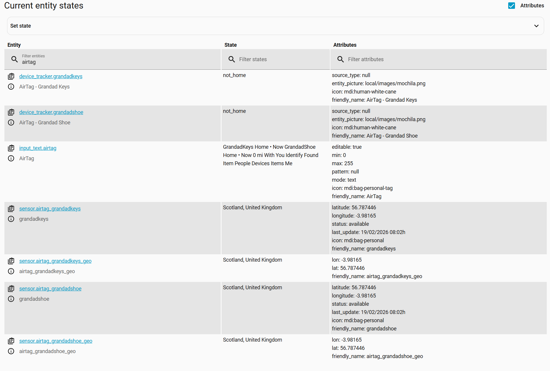

Tried doing the whole thing again. Now it’s showing both tags as in America, lol…

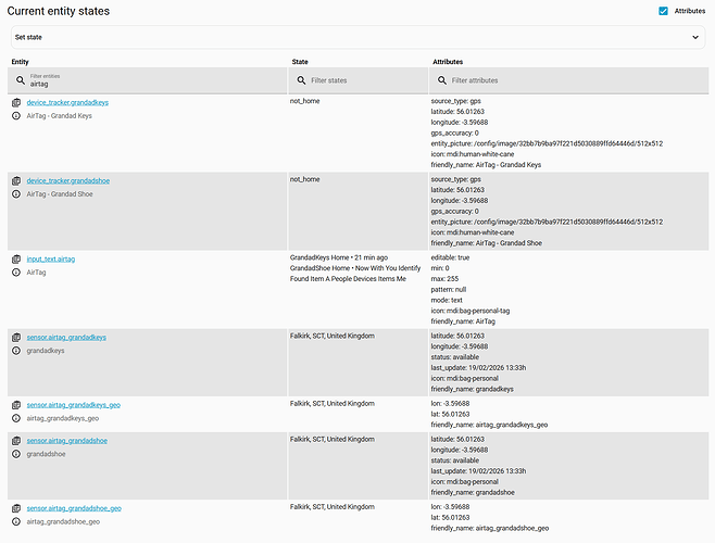

Scratch the above 2 messages. Working now by adding the code that forces “Home” to lower case.

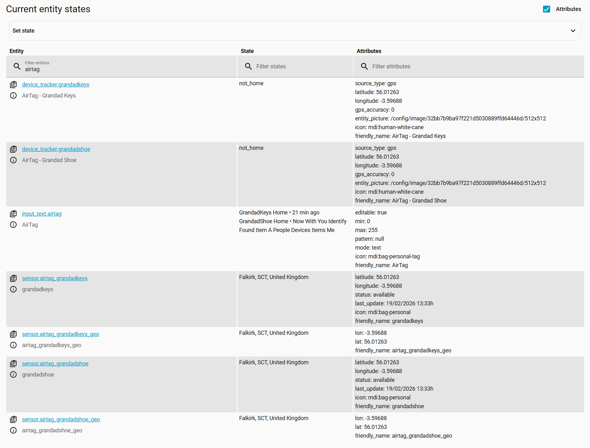

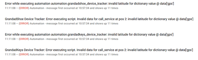

The only issue I have now is that the trackers are shown as “Away” when they are inside the “Home” zone within HA. Error in log shows…
Device Tracker location is also not updating when the sensor is updated.
Should I even have this many entities for 2 Airtags? Both *.geo entities show on the map, but only one of Device trackers show, and it never updates.

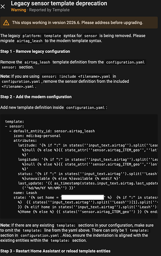

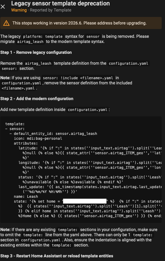

I’m excited to add this integration, and have gotten a good bit of it done, but on first restart of HA, I get a warning about Legacy sensor template deprecation:
Is there an updated sensor definition I can use? this thread is gigantic and tricky to search.
Also, unfortunately the leash sensor is showing up in HA, but all its states are Unknown except for last update time. I’m clueless how to troubleshoot this.

Unfortunately, with the template change the instructions for keeping this integration working are no longer coherent enough for me to make this work.
The whole “how to” needs a rewrite that goes step by step with the new template system.
this describes the template changes. if you can’t get it to work let me know, i’ll may reqrite the HowTo as i need to expand the amount of trackers from default of 4
Deprecation of legacy template entities in 2025.12 – MRi-LE Selfhosted
So I admit I’m entirely helpless here in implementing these changes. I’m very new to the depths of HASS, and frankly don’t even really understand what the intent of a template is.
Is it possible to get an example of what an AirTag template sensor should look like? Is that even the right terminology?
I tried this with no luck:
## Airtag Integration ##
#template:
- sensor:
  - default_entity_id: sensor.airtag_leash
    icon: mdi:dog-side
    attributes:
      latitude: '{% if ":" in states(''input_text.airtag'').split(''Leash'')[1].split(''•'')[0]
        %}null {% else %}{{ state_attr(''sensor.airtag_ITEM_geo'',''lat'') }} {% endif
      longitude: '{% if ":" in states(''input_text.airtag'').split(''Leash'')[1].split(''•'')[0]
        %}null {% else %}{{ state_attr(''sensor.airtag_ITEM_geo'',''lon'') }} {% endif
      status: '{% if ":" in states(''input_text.airtag'').split(''Leash'')[1].split(''•'')[0]
        %}unavailable {% else %}available {% endif %}'
      last_update: '{{ as_timestamp(states.input_text.airtag.last_updated)|timestamp_custom
        (''%d/%m/%Y %H:%Mh'') }}'
    state: '{% set home = "My Redacted Street" %}  {% if ":" in states(''input_text.airtag'').split(''Leash'')[1].split(''•'')[0]
      %}  {{ states(''input_text.airtag'').split(''Leash'')[1].split(''•'')[0].split('','')[0]
      }} {% elif home in states(''input_text.airtag'').split(''Leash'')[1].split(''•'')[0]
      %}Home {% else %} {{ states(''sensor.airtag_ITEM_geo'') }} {% endif %}'
