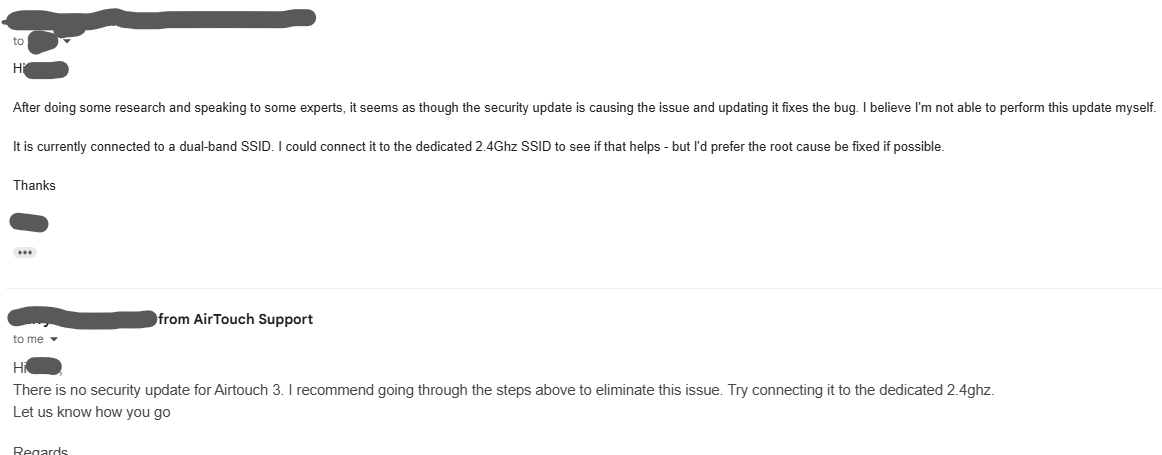

5 May 2022! I got the system installed mid last year!
Is it something I can do or do I get the installer to come back out? I actually want him to check out my system anyway as it performs poorly - likely due to the external unit being too close to the fenceline and not allowing the outgoing air to disperse properly :confused:
Lodge a warranty request with Airtouch and mention you have wifi drop out issues and someone will either come out and do the SD card or they will replace your console with the new version as yours may have the old wall connector which is problematic also.
The SD card needs to be done in certain way so they don’t just send them out.

They think you have a Airtouch 3, you have a Airtouch 5 reply to them that your have a Airtouch 5 and provide them the Airtouch ID number so they can look at the drop out history etc
